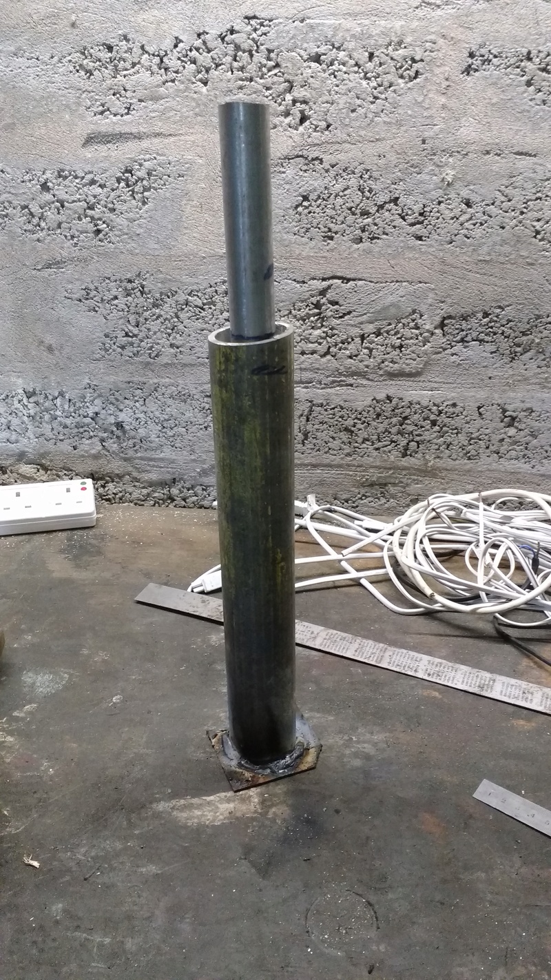

So, finally got some time to work on this. Been busy servicing/repairing other mowers and of course exams Razz
The next thing I needed to do was re-do the exhaust system. I wanted it to be compact and not interfere with linkages etc. I didn't want a straight pipe because it would be too loud for utility work, but I didn't want it to sound like a stock engine. On the Westwood frame, there is a hole below the exhaust port which was used for the exhaust on some models. I decided to use that to route the exhaust below the frame and build a muffler to go just underneath the frame below the engine.
'86 Westwood T1200 - Page 12 Img_2013
'86 Westwood T1200 - Page 12 Img_2014
Using this big piece of 2" O.D pipe as the outer casing of the muffler.

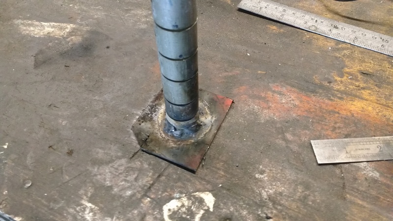

Then for the inner pipe of the muffler I used a piece of 1" pipe, cutting slots in it with the grinder.
'86 Westwood T1200 - Page 12 Img_2018
Welded the pipe to the base plate
'86 Westwood T1200 - Page 12 Img_2019
Welded the outer pipe over it. I might change the outer pipe for a slightly smaller one with a smaller wall thickness, because I think the one that is on it is too heavy.

Looks pretty cool so far! Should be pretty neat having it all tucked away like that. How close is the header pipe gonna be to the carburetor bowl?

Thanks. Hopefully it will be clearer what I'm doing when it's finished.
Thanks Allis! That's the reason I put it there, because it doesn't interfere with anything and should keep out of the way. I hope the header won't be too close to the bowl, I think the angle of the pic makes it look like it would be closer. It was pretty close before, and on the stock mufflers it is almost touching the bowl so I think it should be okay. It hasn't got a plastic float so it shouldn't melt, haha.

Yeah some stock mufflers are awfully close, worst case scenario you could make a little heat shield or something.

So are you making a glass pack?
A heat shield would be a good idea, don't want to risk a fire or anything.
Yes, sorta haha. It will make more sense once I get it finished. The plan is for the header pipe to go in at one end, then the exhaust gasses pass through the slits in the smaller pipe which will quieten it down a bit, and come on the other end. I'll probably just have the pipe pointing down at an angle away from the frame.

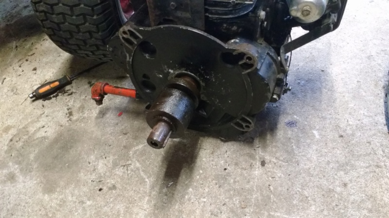

Got this 11.5hp Briggs for £40, including fuel tank, wiring loom, engine pulley and throttle cable, so it will be going on the Westwood at least until the 12hp is rebuilt. I think this engine came from a Countax RER, due to the exhaust and fuel tank placement, and it says 'Countax Rider' on the wiring circuit board.
'86 Westwood T1200 - Page 12 Img_2075
Unfortunately the engine pulley is stuck on the shaft, it is two parts, the deck pulley and the trans drive pulley. The deck pulley was removed when I got it but the top pulley is really stuck on. I'm going to hopefully get the lend of a hydraulic puller tomorrow and see if it comes off.
'86 Westwood T1200 - Page 12 Img_2076
