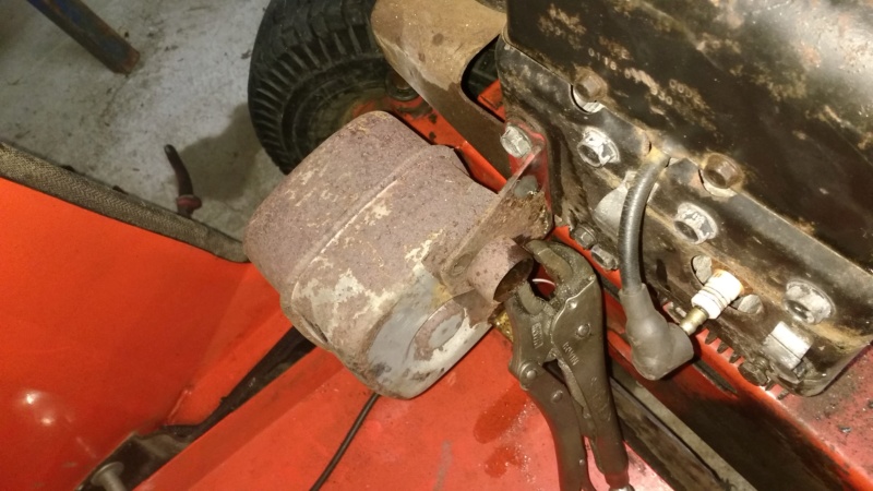

Finally got the exhaust off that bracket by cutting the bolt. Reinstalled it directly to the block. Fuel line is running quite close to the muffler though but it should be okay.

Nice to see it running again. I highly recommend moving the fuel line. I love electrical I’m looking forward to you wiring this rig.

Thanks Carl! That is the stock routing of the fuel line, but there is meant to be a steel sleeve go over the line to protect it but I the old fuel line was rotten and cracked so I replaced it with some I had laying around and the O.D is too big for the sleeve to fit on. I will buy the proper size line and reinstall the sleeve soon.

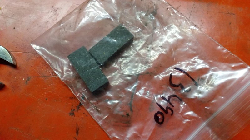

Took off the brake caliper to install the brake pad, but I found out that the actuating dowel pins had also fallen out with the pads, so I will either have to make or buy some of those.
