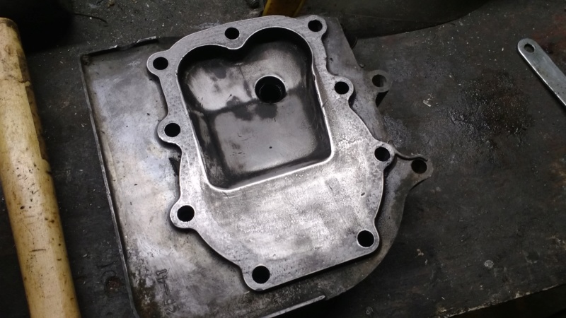

So if you remember a while back one of the brake caliper bolts from the trans fell out and the brake pads, backing plate and dowel pins fell out. I ordered up a piece of 8mm Stainless steel rod to make the brake dowel pins from, which arrived today.
'86 Westwood T1200 - Page 14 Img_2095
Cut into 3/4" lengths. I just did this with the angle grinder and squared the ends up with a buffing disk. Turned out quite good.
'86 Westwood T1200 - Page 14 Img_2096
Also cut out a new backing plate.
'86 Westwood T1200 - Page 14 Img_2097
Drilled out and tapped the trans case for an M8 bolt and assembled it together. The threads for the other bolt are nearly stripped too so I will need to drill and tap it out too. But anyway I decided to give it a test drive, even though it was dark and I had to jump start it because the recoil rope broke. Feels nice to have brakes again, I need to adjust the linkage a bit though. Next job is to order up another axle bearing (I only ordered one up last time Razz), an input bearing for the trans axle and maybe buy or make a new rear pulley.
