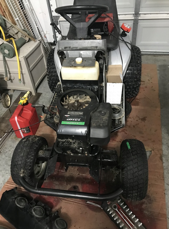

| Hey guys, didn’t get a whole lot done today, girlfriend had me distracted lol Got the engine set on and 3 of the 4 bolts finger tight. Both flywheels are off, looks like I will need a washer to finish the flywheel swap and that’s where I left off for tonight. The shroud is just sitting on the engine. I really love how the black frame looks under the engine. Hoping to be done painting the whole thing by haspin   | |
