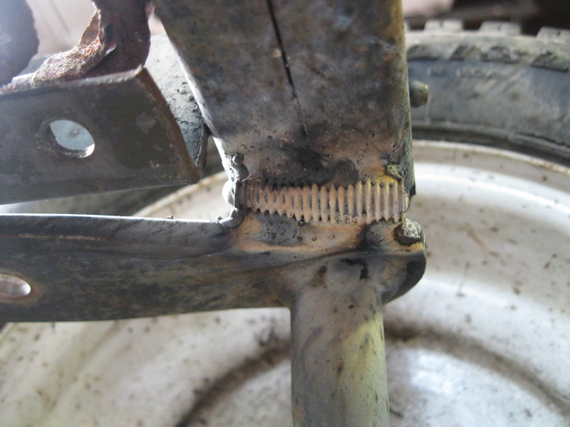

I started off with a section of T beam from a garage door opener system and what I think was a craftsman front axle. Welded the spindles solid with a slight bit of toe-in (which turned out to be a bit too much but it'll work)
Multi use Trailer Img_6225
I welded the spindles at the top, but also I welded some sections of bolts between the axle and spindle at the bottom. They should stay put.

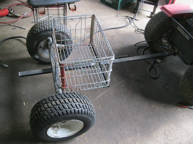

I made everything pretty beefy, just in case I ever use it over rough ground or anything
Multi use Trailer Img_6227
Agway tractor being used for lining up the hitch.
Multi use Trailer Img_6228

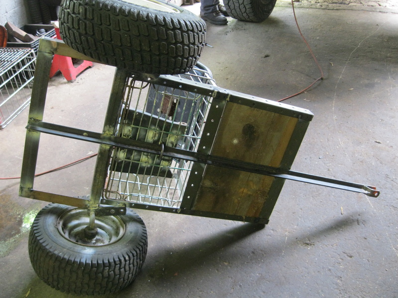

Added some thin angle pieces I had to box everything in and up front I added a wood floor.
Multi use Trailer Img_6229
The seat is hinged to allow access to the storage space below. The steel crate and seat can all be removed from the trailer by removing a U-bolt which holds the metal plate at the bottom. Then the trailer can be used as a flat bed with a board fitted in place of the crate.
