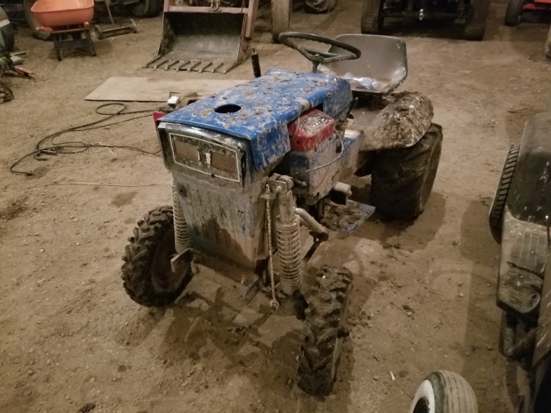

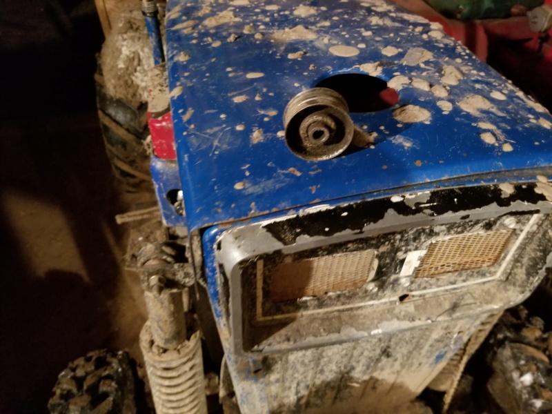

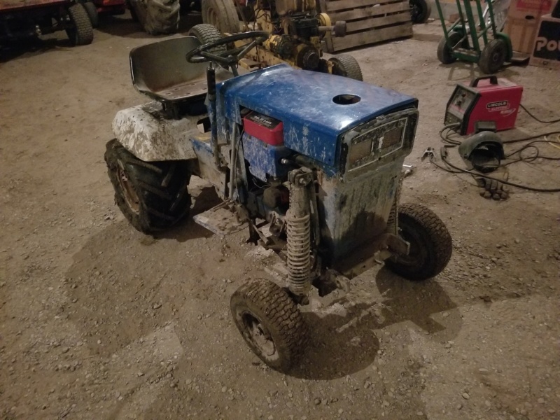

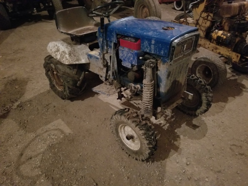

 | Subject: Re: Ford LT 110 Off-Road Build December 1st 2019, 12:05 am | |

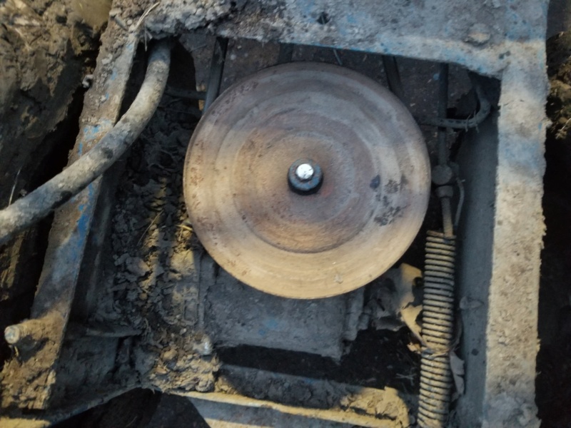

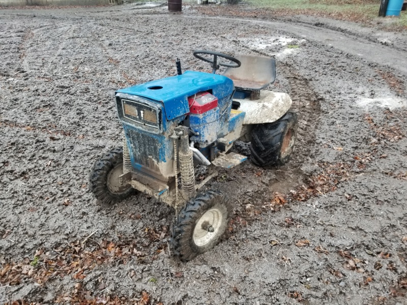

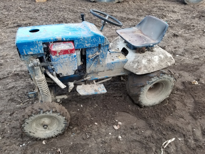

| Got the little Ford pushed outside and got it driving again tonight.  Didn't just slap a belt on it like I initially planned though. I've been meaning to drop the rear pulley size to speed 'er up, but just hadn't done it yet. I figured this was as good a time as any! Anyway, the big ol' factory pulley didn't fair so well, but I got it off:  About a 6" pulley went in it's place.   With the 5" one on the front it gave 'er some pretty good speed. The torquey ol' oppy will still idle in third though once you're rolling though, haha. I didn't get an actual speed reading on it, but she moves buddy!  Then lastly, a quick mock up of the front wheels I'll be running on it:   I like it so far! I just have to modify the spindles a bit as these rims have a much longer hub than a standard lawn tractor rim, so the spindles are too short. But that'll be easy. Hoping to get that done tomorrow!  "This'll either wake you up or put you to sleep forever!"- Red Green "Whatever you do you should do right, even if it's something wrong." - Hank Hill - MTD Off-Road Build - Ford LT 110 Off-Road Build - Craftsman GT 6000 Off-Road Build - Sears LT11 Rat Rod Build *2019 Build-Off Winner!* - Allis B-110 x2, 710 & 716 - Wheel Horse 655, 953 & 500 Special - Case 444 - Bolens Versamatic & 1668 - Cub 106 & 124 - Ford 120, LGT 125 & 145 - White 1650 Yard Boss *I have 21 tractors and over 40 chainsaws, I need help* | |

 | Subject: Re: Ford LT 110 Off-Road Build December 1st 2019, 12:19 am | |
| The is a neat build. Those fronts and rears off the Jacobsen? | |
Age : 48 Join date : 2016-09-06 Points : 13137 Posts : 9297 Location : Oklahoma
 | Subject: Re: Ford LT 110 Off-Road Build December 1st 2019, 12:21 am | |
| MAN, those new front tires make a big difference. I like 'em! | |

| Thanks fellas! Yeah they change the look for sure. Should be a real an improvement in the steering department too.  "This'll either wake you up or put you to sleep forever!"- Red Green "Whatever you do you should do right, even if it's something wrong." - Hank Hill - MTD Off-Road Build - Ford LT 110 Off-Road Build - Craftsman GT 6000 Off-Road Build - Sears LT11 Rat Rod Build *2019 Build-Off Winner!* - Allis B-110 x2, 710 & 716 - Wheel Horse 655, 953 & 500 Special - Case 444 - Bolens Versamatic & 1668 - Cub 106 & 124 - Ford 120, LGT 125 & 145 - White 1650 Yard Boss *I have 21 tractors and over 40 chainsaws, I need help* | |

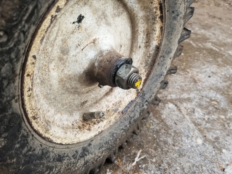

| Thanks Beal, I think so too! I actually got the spindles done today and installed the new wheels:  The nut goes up against the inner bearing race, so there's no need for a double nut. I might add one on each side just to be sure though. They fit good!  No clearance issues or anything, perfect! Couple off-road shots:    Let me know what ya think!  "This'll either wake you up or put you to sleep forever!"- Red Green "Whatever you do you should do right, even if it's something wrong." - Hank Hill - MTD Off-Road Build - Ford LT 110 Off-Road Build - Craftsman GT 6000 Off-Road Build - Sears LT11 Rat Rod Build *2019 Build-Off Winner!* - Allis B-110 x2, 710 & 716 - Wheel Horse 655, 953 & 500 Special - Case 444 - Bolens Versamatic & 1668 - Cub 106 & 124 - Ford 120, LGT 125 & 145 - White 1650 Yard Boss *I have 21 tractors and over 40 chainsaws, I need help* | |

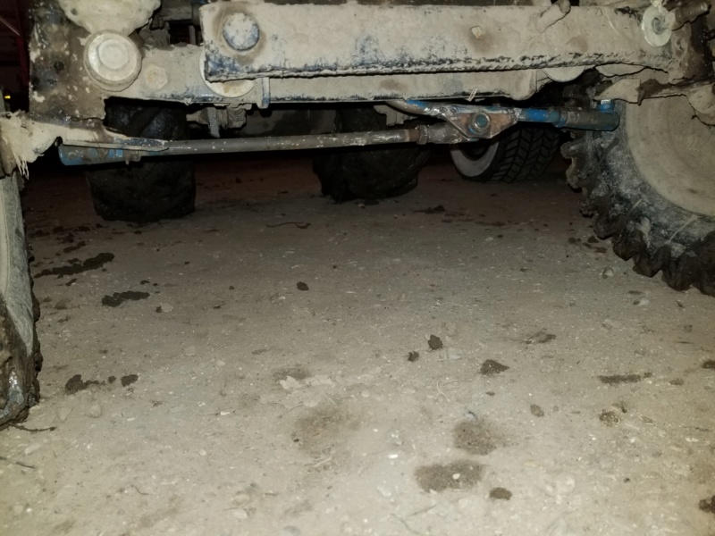

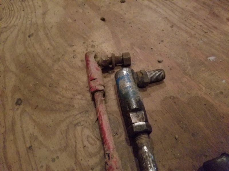

 | Subject: Re: Ford LT 110 Off-Road Build December 15th 2019, 12:11 am | |
| Little more tinkering here tonight:  Been wanting to upgrade the rods and ends on the cross-over steering setup for a while now, just make it a bit better looking and heavier duty. I actually used the tie-rod and drag link from the little parts tractor, since it had garden tractor sized rods and ends on it, and I didn't have to modify them too much to make them work.   Nice 1/2" stuff now, much better!    Very happy with how it went together. Got the wheel toe dialed in and she felt great on the test drive. Nice to have that done!  "This'll either wake you up or put you to sleep forever!"- Red Green "Whatever you do you should do right, even if it's something wrong." - Hank Hill - MTD Off-Road Build - Ford LT 110 Off-Road Build - Craftsman GT 6000 Off-Road Build - Sears LT11 Rat Rod Build *2019 Build-Off Winner!* - Allis B-110 x2, 710 & 716 - Wheel Horse 655, 953 & 500 Special - Case 444 - Bolens Versamatic & 1668 - Cub 106 & 124 - Ford 120, LGT 125 & 145 - White 1650 Yard Boss *I have 21 tractors and over 40 chainsaws, I need help* | |

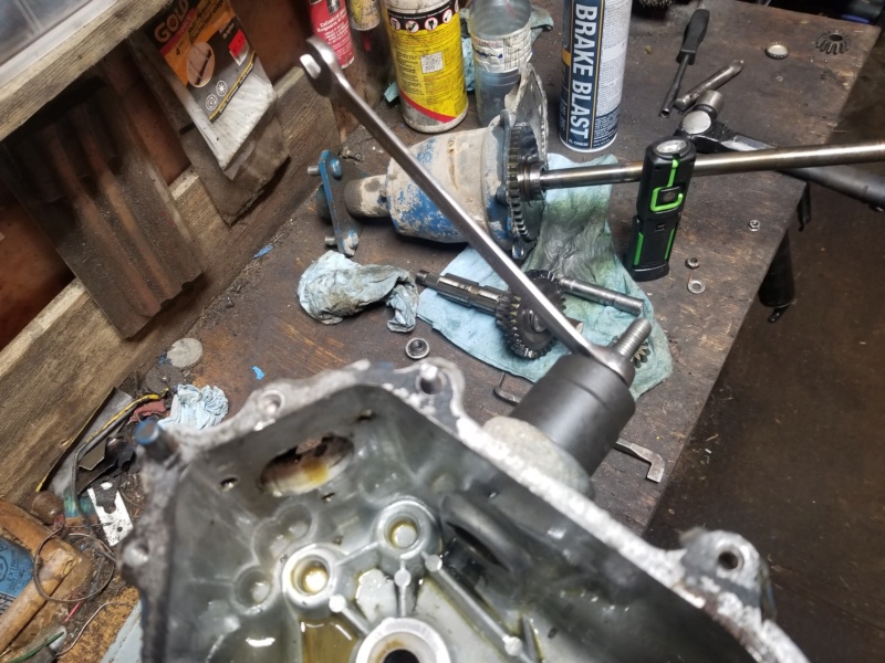

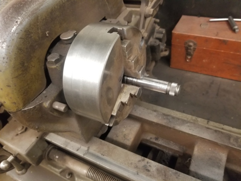

 | Subject: Re: Ford LT 110 Off-Road Build January 28th 2020, 6:33 am | |

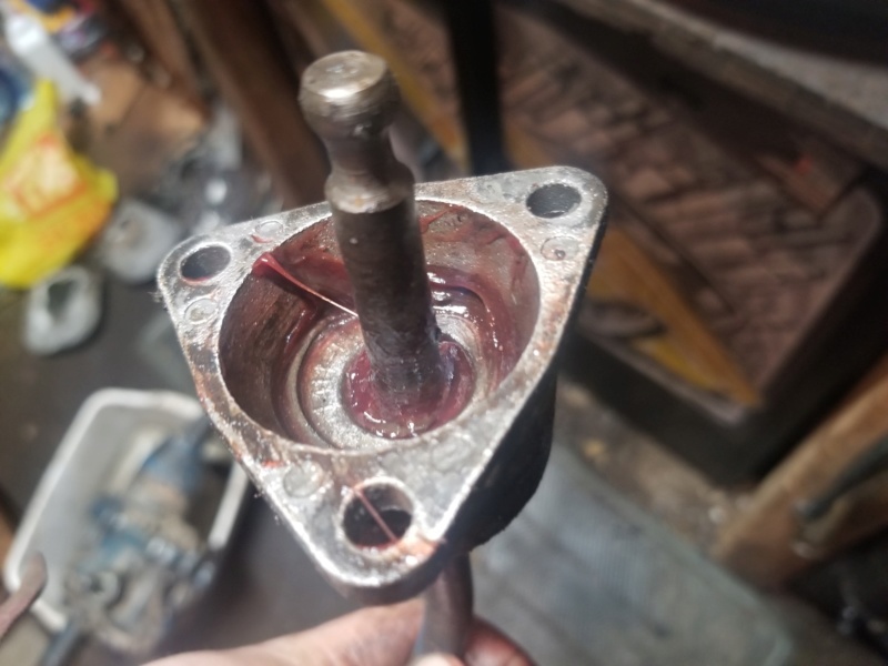

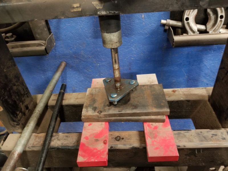

| Haha, no you're right it definitely has been long enough! Anyhow I got the trans tore down enough to get to the pinion shaft. Made a little puller and got the shaft pulled out a little bit, but I broke it twice so I'm gonna have to come up with a different idea.  Moved it a little ways though:  All the other internals look fine from what I saw, so I shouldn't have any problems there.  However the needle bearing for the main shaft fell apart upon splitting the case, so looks like I will have to track one of those down and most likely check the others. I guess she's sitting for a little bit:  Oh well, hopefully we'll be back together in no time!  "This'll either wake you up or put you to sleep forever!"- Red Green "Whatever you do you should do right, even if it's something wrong." - Hank Hill - MTD Off-Road Build - Ford LT 110 Off-Road Build - Craftsman GT 6000 Off-Road Build - Sears LT11 Rat Rod Build *2019 Build-Off Winner!* - Allis B-110 x2, 710 & 716 - Wheel Horse 655, 953 & 500 Special - Case 444 - Bolens Versamatic & 1668 - Cub 106 & 124 - Ford 120, LGT 125 & 145 - White 1650 Yard Boss *I have 21 tractors and over 40 chainsaws, I need help* | |

 | Subject: Re: Ford LT 110 Off-Road Build January 30th 2020, 11:37 am | |
| Yeah they're real neat, definitely pretty well built like you said. I think some of these components are shared with the Peerless 1200, but I'm not positive. Anyhow, made some good progress over the last few days. Finally got the pinion shaft out and checked out the damage:  Pretty much the same as last time, haha. Right by my fingers is where the bad spot it. You can see the raised spots from the metal transfer when it seized to the bushing. Pretty bad. Next thing I did was press the pinion bushing out:  Now last time this happened I used a spare transaxle to put together with the bearings, so I didn't have to worry about saving the shaft that time around. However, this time I wanted to re-use the trans and all the parts so I used the best way I could think of to fix the damaged shaft. Pretty much just chucked it up and cleaned it off.  Didn't have to make any actual cuts, I just went at it with some coarse grit emory cloth and then polished it up with some fine stuff. Turned out really well!  Can't catch any spots with a fingernail, and I didn't undersize it, so I'm thinking it will be good. Gonna go see about picking up some bearings today, so hopefully I'll have good luck with that!  "This'll either wake you up or put you to sleep forever!"- Red Green "Whatever you do you should do right, even if it's something wrong." - Hank Hill - MTD Off-Road Build - Ford LT 110 Off-Road Build - Craftsman GT 6000 Off-Road Build - Sears LT11 Rat Rod Build *2019 Build-Off Winner!* - Allis B-110 x2, 710 & 716 - Wheel Horse 655, 953 & 500 Special - Case 444 - Bolens Versamatic & 1668 - Cub 106 & 124 - Ford 120, LGT 125 & 145 - White 1650 Yard Boss *I have 21 tractors and over 40 chainsaws, I need help* | |

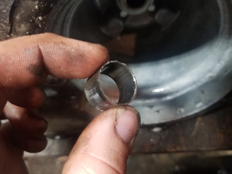

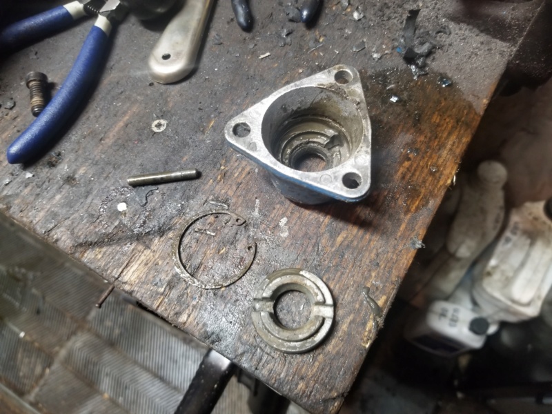

 | Subject: Re: Ford LT 110 Off-Road Build March 1st 2020, 11:53 pm | |
| Well I finally made some more progress on the 600 repair over the last couple days. Got some NOS gaskets this time so no need to mess around with RTV stuff.  Went a different route with the pinion shaft this time and used a bronze bushing:  Little experiment I guess, I think it will work well though. Mostly back together:  Dissassembled the shifter cup to clean it up and grease it:   Then the shifter went in and she was done:  Going to hopefully throw it back under the little tomorrow and get 'er rolling again!  "This'll either wake you up or put you to sleep forever!"- Red Green "Whatever you do you should do right, even if it's something wrong." - Hank Hill - MTD Off-Road Build - Ford LT 110 Off-Road Build - Craftsman GT 6000 Off-Road Build - Sears LT11 Rat Rod Build *2019 Build-Off Winner!* - Allis B-110 x2, 710 & 716 - Wheel Horse 655, 953 & 500 Special - Case 444 - Bolens Versamatic & 1668 - Cub 106 & 124 - Ford 120, LGT 125 & 145 - White 1650 Yard Boss *I have 21 tractors and over 40 chainsaws, I need help* | |
 | Subject: Re: Ford LT 110 Off-Road Build March 2nd 2020, 12:20 am | |
| Nice AK! I'm not sure what was in place of the bushing, but the bronze one should work out fine! Can't wait to see the old ford rollin' again! | |
