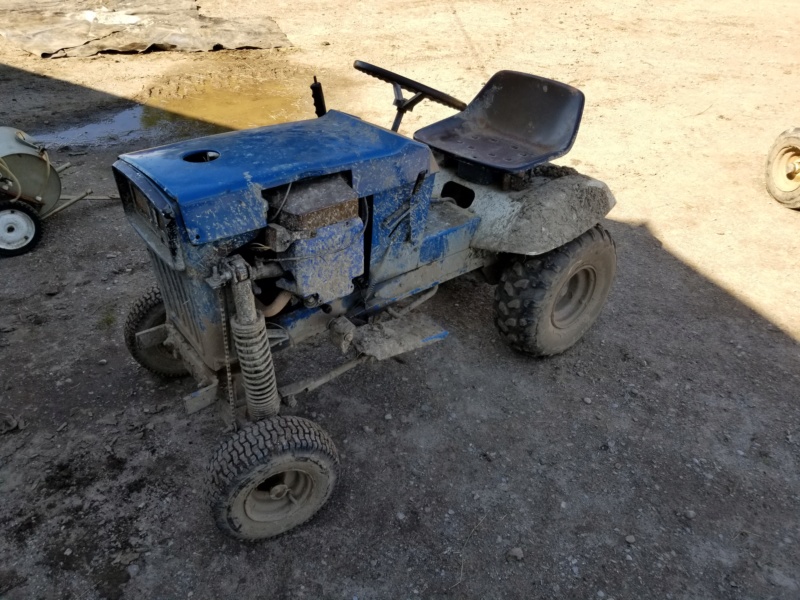

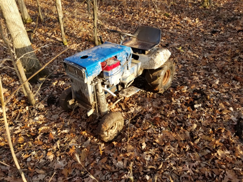

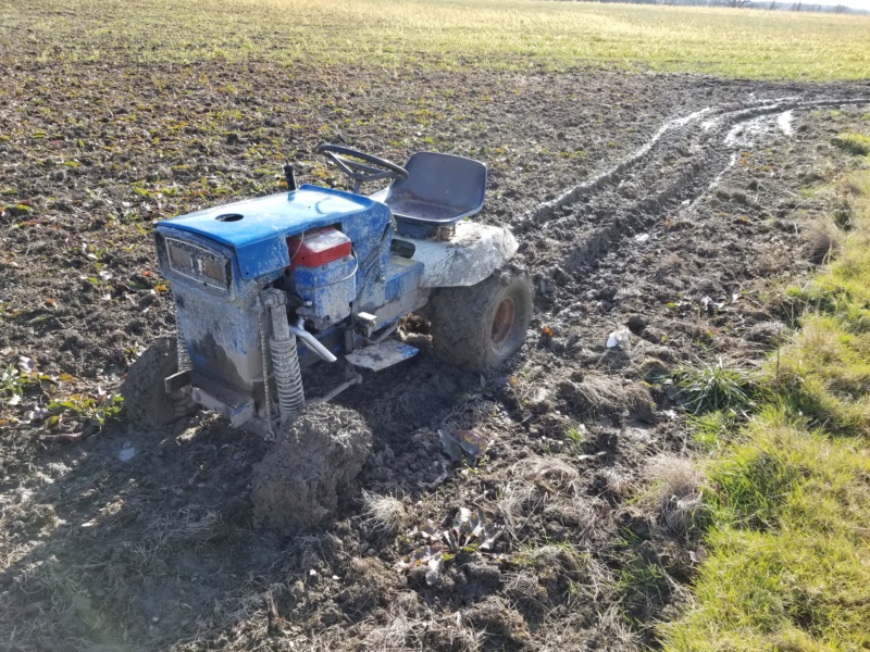

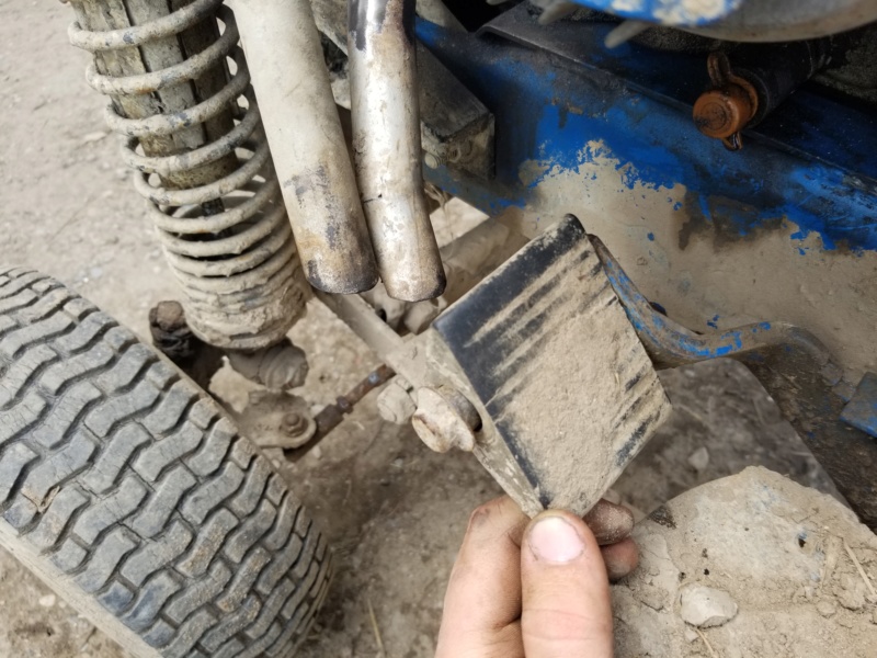

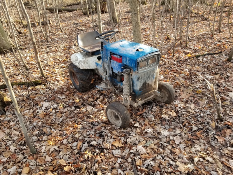

| Had the little Ford out this weekend. Hadn't been started in weeks so it was a grumpy thing for a little bit, but she finally came around after some driving around and a splash of fresh gas in the tank. Pretty much the only thing around here this time if year is mud, so that's what we ended up playing in.  Couple screenshots from a video I was trying to make:    Then I got a little rammy and slammed across a big rut at full speed, so I ended up breaking a steering rod:  Whoops, hahaha. Had to play tow-truck with the GT and got 'er back to the barn to be fixed up.  I just cleaned up and welded the rod back together and it held up fine for the rest of the day.   I think I'd like to beef up the linkages some now that I've had it break on me, use some nicer rod ends and what not. I've also been thinking about a front skidplate to protect the steering linkage and suspension components. Maybe make the skidplate come up into a neat looking bumper even? We'll have to see, haha. I've got a few Ideas so hopefully I'll be able to make something happen! | |

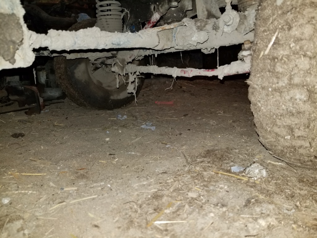

| I like the idea of a pre runner bumper or something like that but I would think it would be more practical as a skid plate if it was mounted to the suspension in some way that it moved with the flex. How do those little front tires manage in the mud? They look pretty small. | |

| - muckmudd wrote:
- I like the idea of a pre runner bumper or something like that but I would think it would be more practical as a skid plate if it was mounted to the suspension in some way that it moved with the flex. How do those little front tires manage in the mud? They look pretty small.
Yeah that's a neat idea, it might be slightly difficult being that it's an independent setup, but I might be able to make something work. The tires aren't too bad, just not fantastic for steering being that they're only turfs. I have front tires in mind that I'd like for it I just gotta find some, haha. - MightyRaze wrote:

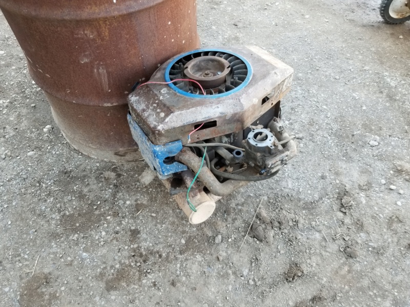

| It does make a bit of a noise when I turn it that sounds like it's coming from inside the cylinder. The upper one too, so I wonder if that cylinder was starved of oil or something.
Really though this engine is pretty tired, it has been burning quite a bit of oil for some time now and seems to be really easy to stall. I was actually thinking that if I could figure out the issue with my 16hp pressure lube opposed, it would be a good replacement for this engine. _______________________________________________ "This'll either wake you up or put you to sleep forever!"- Red Green "Whatever you do you should do right, even if it's something wrong." - Hank Hill - MTD Off-Road Build - Ford LT 110 Off-Road Build - Craftsman GT 6000 Off-Road Build - Sears LT11 Rat Rod Build *2019 Build-Off Winner!* - Allis B-110 x2, 710 & 716 - Wheel Horse 655, 953 & 500 Special - Case 444 - Bolens Versamatic & 1668 - Cub 106 & 124 - Ford LGT 125 & 145 - White 1650 Yard Boss | |

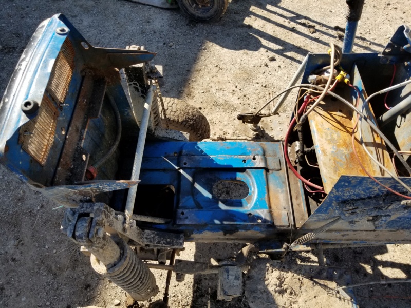

| Well it would appear that the little Ford has become a bit of a back burner project ever since the engine locked up, but today I finally got around to doing some work on the ol' girl today. First time she's seen the sun in a while!  Got it up on the jack stands to start taking the belt off and what not:  Then here we are, one Ford with engine on the side!   Unfortunately I wasn't gonna have enough time to swap the new engine in or anything, so I just gave the engine bay area a good cleaning:  Pretty good now. Also in case I didn't mention it, the engine that will be going in is my pressure lube model 40 that came out of the MTD a while back:  Has an issue with not wanting to start, but I think I can get it figured out. Better than a siezed enging anyways, haha. Hopefully I can get some more work done on 'er soon! _______________________________________________ "This'll either wake you up or put you to sleep forever!"- Red Green "Whatever you do you should do right, even if it's something wrong." - Hank Hill - MTD Off-Road Build - Ford LT 110 Off-Road Build - Craftsman GT 6000 Off-Road Build - Sears LT11 Rat Rod Build *2019 Build-Off Winner!* - Allis B-110 x2, 710 & 716 - Wheel Horse 655, 953 & 500 Special - Case 444 - Bolens Versamatic & 1668 - Cub 106 & 124 - Ford LGT 125 & 145 - White 1650 Yard Boss | |

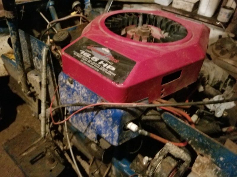

| Tiny bit more progress over the weekend, I got the pressure lube model 40 dropped in the engine bay:   I decided to put the blue cylinder head tins on this engine cuz I thought it'd be an interesting contrast to the bright red blower shroud. Looks pretty good to me! So anyways, next I gotta get some exhaust made, put a carb on it, and hook up all the wiring and cables, then I can try and get it started. Hopefully I'll get to that soon. _______________________________________________ "This'll either wake you up or put you to sleep forever!"- Red Green "Whatever you do you should do right, even if it's something wrong." - Hank Hill - MTD Off-Road Build - Ford LT 110 Off-Road Build - Craftsman GT 6000 Off-Road Build - Sears LT11 Rat Rod Build *2019 Build-Off Winner!* - Allis B-110 x2, 710 & 716 - Wheel Horse 655, 953 & 500 Special - Case 444 - Bolens Versamatic & 1668 - Cub 106 & 124 - Ford LGT 125 & 145 - White 1650 Yard Boss | |

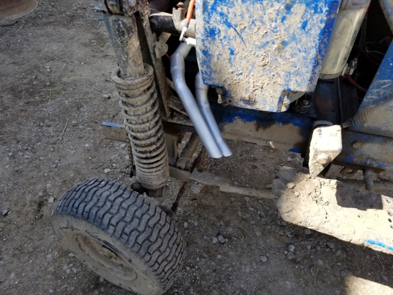

| So I got the exhaust knocked off the list yesterday. I've been thinking about a different exhaust setup for the MTD, so instead of throwing the old pipes away, I figured I'd try and use them on the Ford! I tried bolting them up and seeing how things looked, but unfortunately the pipes conflicted with the clutch pedal when it was locked down all the way:   So after some notching, bending, welding, and a little magic from a sanding disk, this is what we have!   Little paint:   Little bit closer to getting 'er running again, let me know what ya think! _______________________________________________ "This'll either wake you up or put you to sleep forever!"- Red Green "Whatever you do you should do right, even if it's something wrong." - Hank Hill - MTD Off-Road Build - Ford LT 110 Off-Road Build - Craftsman GT 6000 Off-Road Build - Sears LT11 Rat Rod Build *2019 Build-Off Winner!* - Allis B-110 x2, 710 & 716 - Wheel Horse 655, 953 & 500 Special - Case 444 - Bolens Versamatic & 1668 - Cub 106 & 124 - Ford LGT 125 & 145 - White 1650 Yard Boss | |

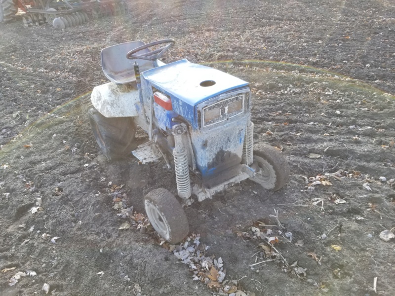

 | Subject: Re: Ford LT 110 Off-Road Build November 26th 2019, 1:38 pm | |

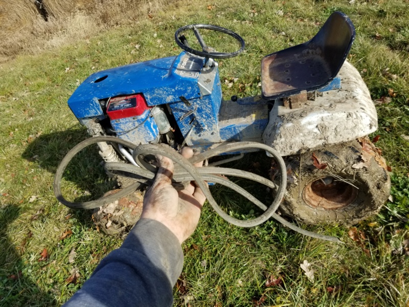

| Well I had 'er out again today. Put a good battery in it so I didn't have to boost it, then I did some adjusting with the steering linkages to get the turning even and the steering wheel straight. Then it was out to the front pasture for some mild wheeling:   Went out to another spot after that and made real mess:  Got it out, but shortly after she snapped the belt on me:  Bugger, haha. Oh well, I had some fun up 'til that point! Now I gotta get a new belt and also make a couple retainers, cuz it could use a few by the engine pulley. I have plans for new front wheels too, but I'll have to modify the spindles first. _______________________________________________ "This'll either wake you up or put you to sleep forever!"- Red Green "Whatever you do you should do right, even if it's something wrong." - Hank Hill - MTD Off-Road Build - Ford LT 110 Off-Road Build - Craftsman GT 6000 Off-Road Build - Sears LT11 Rat Rod Build *2019 Build-Off Winner!* - Allis B-110 x2, 710 & 716 - Wheel Horse 655, 953 & 500 Special - Case 444 - Bolens Versamatic & 1668 - Cub 106 & 124 - Ford LGT 125 & 145 - White 1650 Yard Boss | |

| It's great seeing the Ford out! Sux you busted a belt. I always agree, if you bust something, it's best it be a belt!
