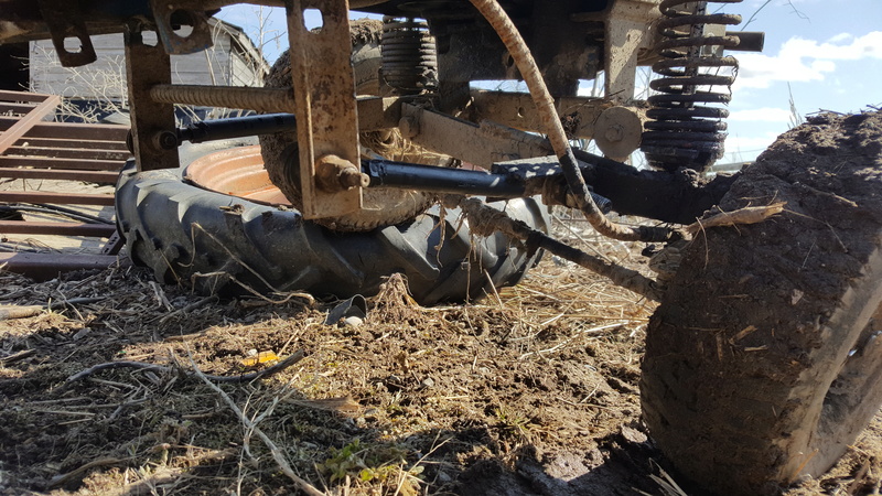

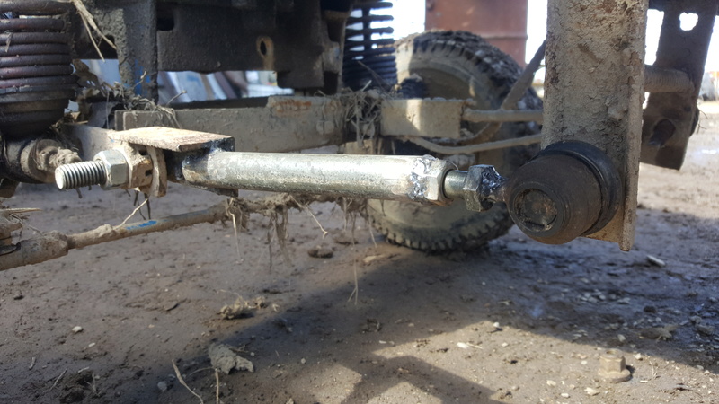

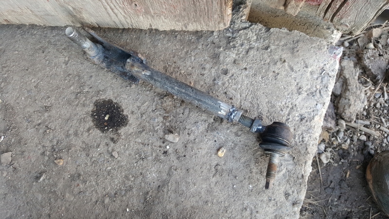

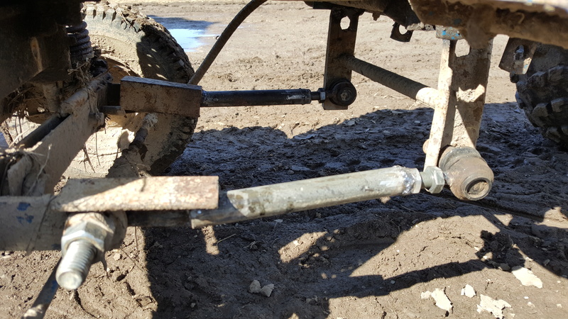

I got some better radius arms made up today. Well technically I modified the old ones. I pretty much just wanted them to be stronger and have adjustable ends.
Here's one of the old one.
Ford LT 110 Off-Road Build - Page 8 20180357
And the new one!
Ford LT 110 Off-Road Build - Page 8 20180358
Much better!
All mounted up.
Ford LT 110 Off-Road Build - Page 8 20180359
Ford LT 110 Off-Road Build - Page 8 20180360
Same thing for the other side.
Ford LT 110 Off-Road Build - Page 8 20180361
Finally both mounted up!
Ford LT 110 Off-Road Build - Page 8 20180362
Ford LT 110 Off-Road Build - Page 8 20180363
Looks a lot better in my opinion! Shouldn't be breaking them anytime soon.
And a couple flex pictures, well not really flex though since it's an IFS setup but y'know. Haha.
Ford LT 110 Off-Road Build - Page 8 20180365
Ford LT 110 Off-Road Build - Page 8 20180364
Ford LT 110 Off-Road Build - Page 8 20180366
Looks a lot nicer and it should hold up better as well. Glad to have that done, haha. Let me know what ya think!

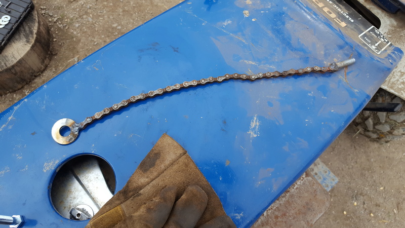

Next thing I did was make a couple of limit straps for the front end to stop the beams from dropping too far.
I figured roller chain would look cool, haha. So here's one made up:
Ford LT 110 Off-Road Build - Page 8 20180554
The upper bracket for that side:
Ford LT 110 Off-Road Build - Page 8 20180555
The nut and bolt allow for some adjustment, I'll probably put jam nuts on them too at some point.
Ford LT 110 Off-Road Build - Page 8 20180556
The lower connection point is just a bolt welded to the axle:
Ford LT 110 Off-Road Build - Page 8 20180557
One side all done!
Ford LT 110 Off-Road Build - Page 8 20180558
Other side now:
Ford LT 110 Off-Road Build - Page 8 20180559
Ford LT 110 Off-Road Build - Page 8 20180560
All done! Works great! Now the front end can be lifted off the ground and the beams stay put instead of dropping all the way down.

Roller chain for limit straps= Cool!!
Points : 8224
Ford LT 110 Off-Road Build - Page 8 Empty
PostSubject: Re: Ford LT 110 Off-Road Build   Ford LT 110 Off-Road Build - Page 8 Icon_minitimeMay 20th 2018, 11:35 pm
Hahaha, thanks prancstaman! I think you mentioned chain as limit straps in the MTD thread one time actually, haha. It definitely does look kinda neat.
Points : 14359
Posts : 10145
PostSubject: Re: Ford LT 110 Off-Road Build   Ford LT 110 Off-Road Build - Page 8 Icon_minitimeMay 20th 2018, 11:46 pm
HAHA... that is pretty cool. Adjustable looking too. Did you get it stuck there?

I got the 2/0 chain for limit straps on all 4 A-frames on the Scorpion. I made it to where I can change the ride heights on all 4 A-frames by just unbolting the top and choose a different link.

Haha, thanks Mighty. Naw she wasn't stuck, I just had to hop off and take a picture, hahaha.
Oh cool, sounds like a good setup.
muckmudd wrote:
Interesting haha but if it works why not.
Sure does, works fantastic.

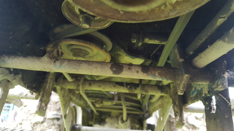

Got a couple pictures of the belt setup. Kinda hard to get under there and get good pictures, but still. Haha.
Ford LT 110 Off-Road Build - Page 8 20180565
Ford LT 110 Off-Road Build - Page 8 20180566
Ford LT 110 Off-Road Build - Page 8 20180567
Again it's nothing really crazy, but it's still super fun. Haha
Made up a simple foot throttle for it too, makes it much nicer to drive!
Ford LT 110 Off-Road Build - Page 8 20180568
Took 'er for a test romp with the foot throttle, haha. Definitely have some belt slippage but I should be able to solve that fairly easy.
