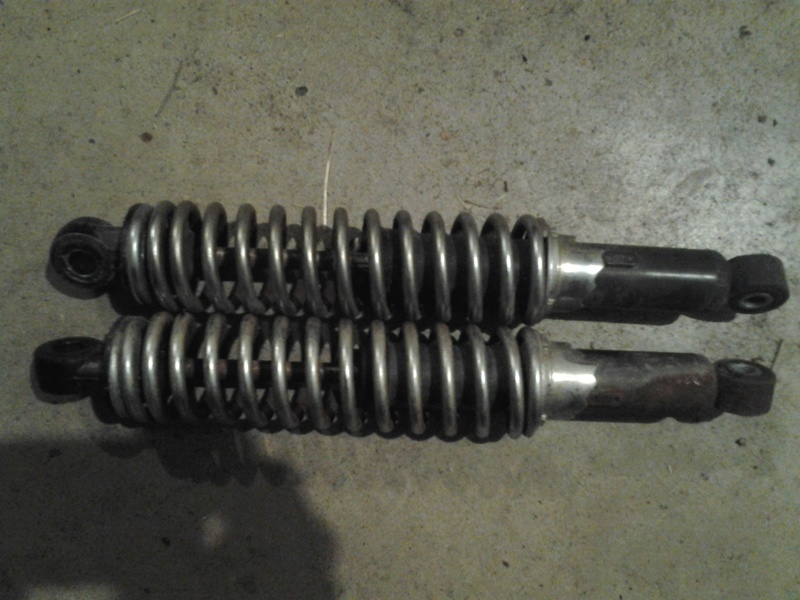

| Got some adjustable coil overs of off a Kawasaki motor cycle today . much softer and they have a lot more travel.  | |
Age : 24 Join date : 2016-07-10 Points : 7949 Posts : 5165 Location : Ontario Canada
 | Subject: Re: 2003 heavily modified Murray Off-road tractor Thu 04 Jan 2018, 7:07 pm | |
| Sweet deal biggas! Hopefully you'll get more suspension travel with those, gonna have to post some flex pictures haha.  "This'll either wake you up or put you to sleep forever!"- Red Green "Whatever you do you should do right, even if it's something wrong." - Hank Hill - MTD Off-Road Build - Ford LT 110 Off-Road Build - Craftsman GT 6000 Off-Road Build - Sears LT11 Rat Rod Build *2019 Build-Off Winner!* - Allis B-110 x2, 710 & 716 - Wheel Horse 655, 953 & 500 Special - Case 444 - Bolens Versamatic & 1668 - Cub 106 & 124 - Ford 120, LGT 125 & 145 - White 1650 Yard Boss *I have 21 tractors and over 40 chainsaws, I need help* | |
biggasmowers Core Member
Age : 22 Join date : 2016-12-30 Points : 4324 Posts : 1943 Location : Kansas
 | Subject: Re: 2003 heavily modified Murray Off-road tractor Thu 04 Jan 2018, 7:08 pm | |
| And they were free too lol

| Well had some trouble putting them on . They are a bit longer than my other ones. I might put the old ones back on to save all the modifying I will have to do to make these new ones work, and the others werent too bad just slightly stuffed than I wanted | |
Age : 48 Join date : 2016-09-06 Points : 13137 Posts : 9297 Location : Oklahoma
 | Subject: Re: 2003 heavily modified Murray Off-road tractor Thu 04 Jan 2018, 9:31 pm | |
| Even adjusted all the way down? That stinks. | |
 | Subject: Re: 2003 heavily modified Murray Off-road tractor Thu 04 Jan 2018, 9:33 pm | |
| Yeah , my links wouldn't allow any up and down movement, but if I move my joints like ak has been telling me to it could work | |
 | Subject: Re: 2003 heavily modified Murray Off-road tractor Thu 04 Jan 2018, 9:37 pm | |
| Could also raise the shock towers a bit. That would allow the new coilovers to fit and bring the front end down a bit so it will sit level when you put better tires on the front  "This'll either wake you up or put you to sleep forever!"- Red Green "Whatever you do you should do right, even if it's something wrong." - Hank Hill - MTD Off-Road Build - Ford LT 110 Off-Road Build - Craftsman GT 6000 Off-Road Build - Sears LT11 Rat Rod Build *2019 Build-Off Winner!* - Allis B-110 x2, 710 & 716 - Wheel Horse 655, 953 & 500 Special - Case 444 - Bolens Versamatic & 1668 - Cub 106 & 124 - Ford 120, LGT 125 & 145 - White 1650 Yard Boss *I have 21 tractors and over 40 chainsaws, I need help* | |

 | Subject: Re: 2003 heavily modified Murray Off-road tractor Thu 04 Jan 2018, 9:39 pm | |
| That would be the second time I have done that tho
It would be the best option in the long run because it's less grinding out of welds | |

| Yeah, I really want a softer setup with those shocks . Idk I will sleep on it and decide while I am working tomorrow

| Well the murray got some beef ! Put new link supports in on the axle that are made out of quarter inch angle and added some gussets too. I am sticking with the original coil overs cause now that its all back together it flexes better and i dont really want to move my top mounts again, but i might later if i feel bored with nothing else to do. Got my knock off go pro camera so should be able to get some footage of it running after i get a new mini sd card.And i am building a better front bumper and hopfully putting a rear one on too. On another note i am getting a stick welder and another angle grinder for trading an old k301 engine thats been laying in my shed for a year or so. | |
