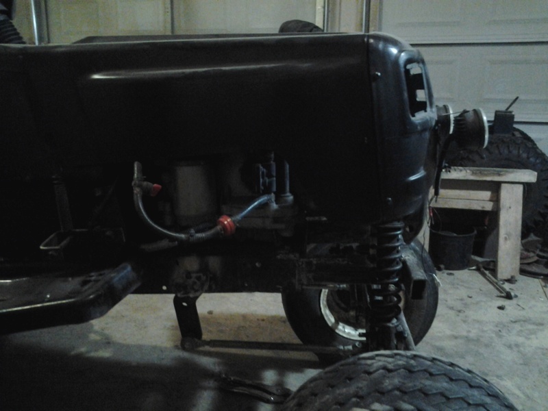

PostSubject: Re: 2003 heavily modified Murray Off-road tractor    2003 heavily modified Murray Off-road tractor  - Page 4 Icon_minitimeTue Dec 26, 2017 1:52 pm
Got some work done on Christmas and this afternoon , Finally moved the shock support forward and made higher brackets to lower the frame some . today i made and put on a sway bar and mounts . 2003 heavily modified Murray Off-road tractor  - Page 4 Img_2047
2003 heavily modified Murray Off-road tractor  - Page 4 Img_2048
2003 heavily modified Murray Off-road tractor  - Page 4 Img_2049

PostSubject: Re: 2003 heavily modified Murray Off-road tractor    2003 heavily modified Murray Off-road tractor  - Page 4 Icon_minitimeTue Dec 26, 2017 2:18 pm
Hey that track rod setup looks pretty good! Should work fine. Decided on a link setup plan yet?

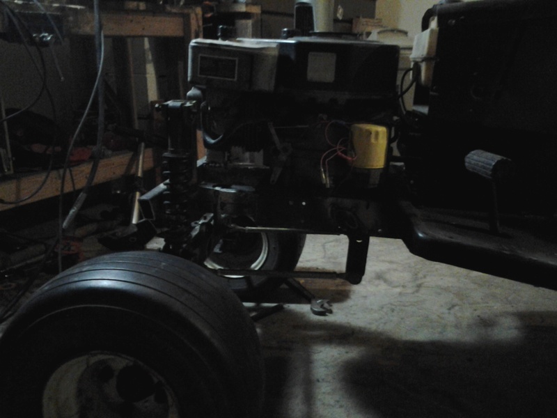

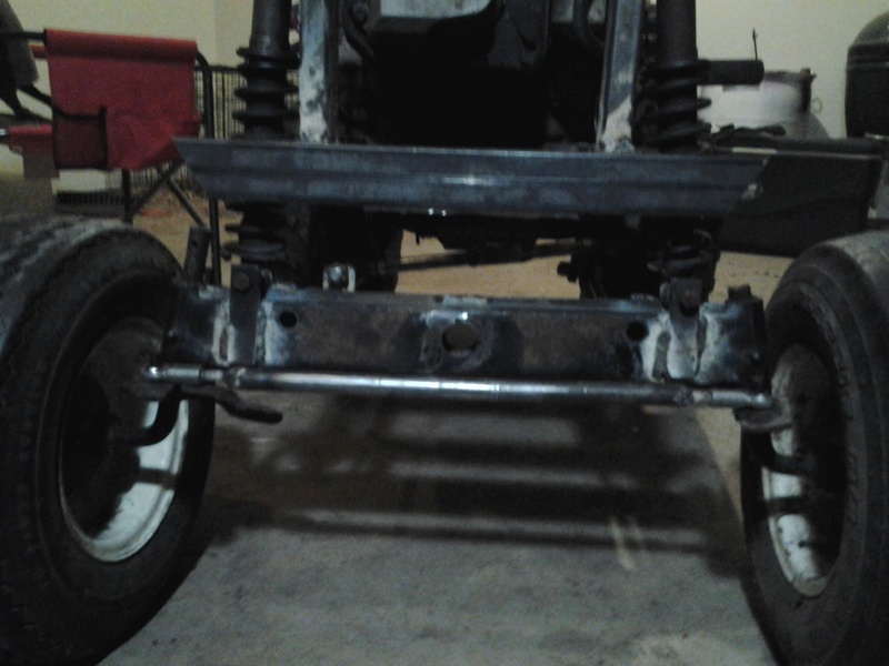

PostSubject: Re: 2003 heavily modified Murray Off-road tractor    2003 heavily modified Murray Off-road tractor  - Page 4 Icon_minitimeTue Dec 26, 2017 6:55 pm
here yea go ak , some pics of my evenings work . Its starting to look like something i will be proud to drive .2003 heavily modified Murray Off-road tractor  - Page 4 Img_2050
theres the other side in. 2003 heavily modified Murray Off-road tractor  - Page 4 Img_2054
front view of linkages2003 heavily modified Murray Off-road tractor  - Page 4 Img_2051
some more pics of the design2003 heavily modified Murray Off-road tractor  - Page 4 Img_2052
looking big and black again !2003 heavily modified Murray Off-road tractor  - Page 4 Img_2055
Needs some severe hood modification to make the hood fit again .2003 heavily modified Murray Off-road tractor  - Page 4 Img_2053
Heres the reason there isnt a third link on the top of the setup.2003 heavily modified Murray Off-road tractor  - Page 4 Img_2056

PostSubject: Re: 2003 heavily modified Murray Off-road tractor    2003 heavily modified Murray Off-road tractor  - Page 4 Icon_minitimeWed Dec 27, 2017 9:08 am
looks good, just brace up your frame side mounts before you ride it much, they look like they would bend with a good hit. I love seeing all these front suspension builds. Makes me want to build one

PostSubject: Re: 2003 heavily modified Murray Off-road tractor    2003 heavily modified Murray Off-road tractor  - Page 4 Icon_minitimeWed Dec 27, 2017 11:20 am
Looks good biggas! Only thing I would do is turn the lower joints 90* so once all the links are done and bolted up the axle doesn't want to tilt back and forth. It looks good though, very clean looking!

PostSubject: Re: 2003 heavily modified Murray Off-road tractor    2003 heavily modified Murray Off-road tractor  - Page 4 Icon_minitimeSat Dec 30, 2017 12:27 pm
All its missing is a drag link , i also found some softer coil overs to give it more absorbtion but havent picked them up yet, 2003 heavily modified Murray Off-road tractor  - Page 4 Img_2061
This is my solution to putting in a single drag link while still using the murray steering system .2003 heavily modified Murray Off-road tractor  - Page 4 Img_2060

PostSubject: Re: 2003 heavily modified Murray Off-road tractor    2003 heavily modified Murray Off-road tractor  - Page 4 Icon_minitimeSat Dec 30, 2017 12:31 pm
Looking really clean biggas! I wouldn't rely on the coilovers to hold the axle from tilting though, they're not meant for that and that's how they get snapped off. Gonna be a test drive video once she's sll done?

PostSubject: Re: 2003 heavily modified Murray Off-road tractor    2003 heavily modified Murray Off-road tractor  - Page 4 Icon_minitimeSat Dec 30, 2017 1:21 pm
Well it looks good but I drew a couple things out to show you.
Basically just refering to the joints being vertical on your axle. When I mounted my center link that way it wouldn't lock the axle solid and it would try and tilt back and forth. I just welded the joint solid and it fixed it.
2003 heavily modified Murray Off-road tractor  - Page 4 20171104
2003 heavily modified Murray Off-road tractor  - Page 4 20171105
Also maybe add a couple of gussets to the mounts just so they dont try and bend.
2003 heavily modified Murray Off-road tractor  - Page 4 20171106
Other than that it seems okay!
