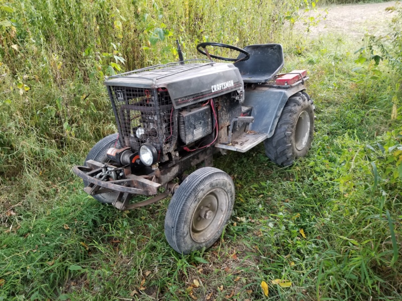

| Sure did! I actually had 'er out again for a while yesterday and snapped a couple pictures while I was at it:     Then back to the shed once again:  She's still working good!  "This'll either wake you up or put you to sleep forever!"- Red Green "Whatever you do you should do right, even if it's something wrong." - Hank Hill - MTD Off-Road Build - Ford LT 110 Off-Road Build - Craftsman GT 6000 Off-Road Build - Sears LT11 Rat Rod Build *2019 Build-Off Winner!* - Allis B-110 x2, 710 & 716 - Wheel Horse 655, 953 & 500 Special - Case 444 - Bolens Versamatic & 1668 - Cub 106 & 124 - Ford 120, LGT 125 & 145 - White 1650 Yard Boss *I have 21 tractors and over 40 chainsaws, I need help* | |

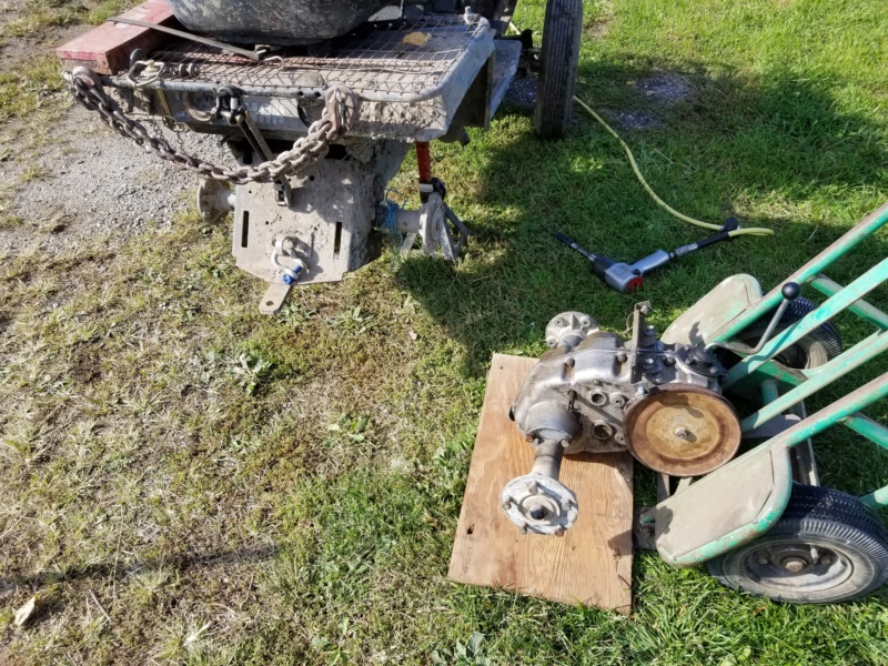

| Well the day has FINALLY come to turn the ol' GT back into a six-speed:  Yep, after a long hard search I finally got ahold of a replacement transaxle for this old girl a few days ago and got it swapped in today. You can tell which one is the replacement, haha:  Had to swap the main shifter, range selector post, and check plug from the old trans to the new one, but it bolted right in otherwise.  Works good!   Sure is nice to have the road gear back, that was kind of inconvenient before I gotta say, haha. Also this trans seems to make a lot less noise than the other one did, so that's good too. All around I'm quite happy!  "This'll either wake you up or put you to sleep forever!"- Red Green "Whatever you do you should do right, even if it's something wrong." - Hank Hill - MTD Off-Road Build - Ford LT 110 Off-Road Build - Craftsman GT 6000 Off-Road Build - Sears LT11 Rat Rod Build *2019 Build-Off Winner!* - Allis B-110 x2, 710 & 716 - Wheel Horse 655, 953 & 500 Special - Case 444 - Bolens Versamatic & 1668 - Cub 106 & 124 - Ford 120, LGT 125 & 145 - White 1650 Yard Boss *I have 21 tractors and over 40 chainsaws, I need help*

 | Subject: Re: Craftsman GT 6000 Build October 20th 2019, 11:02 pm | |
| Good to see the ol' GT get that trans swap. Are you going to bust it open to see what happened? | |

Thanks Mighty. Yeah I was thinking about maybe doing that sometime, sorta curious about what the deal was. - RichieRichOverdrive wrote:

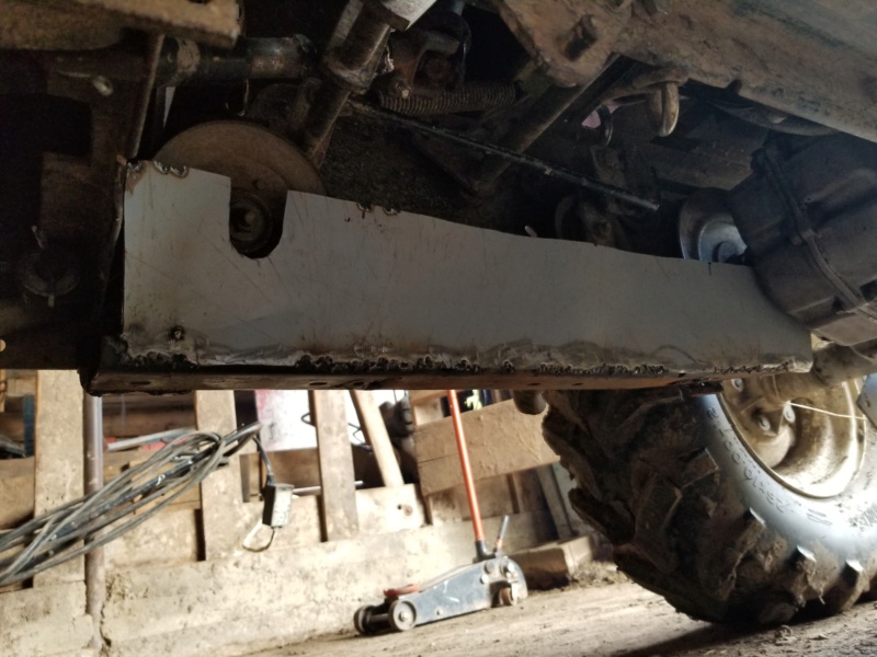

| Thanks fellas! Yeah 3/16" steel might be a bit overkill, but oh well. I'm a fan of overkill with certain stuff anyways, haha. I actually got a pretty good start on the belt guard this evening, I was gonna make the skidplate and belt guard all one piece but decided to make them seperate just for ease of removal. But anyways, here's the bones of the belt guard:   Used the 3/16" steel for that part so I could drag it over stuff without worrying about bending it. For the side protection I just cut out a piece of sheet steel and made it fit pretty nice:  Looks good, time to burn it in!  Kind of a pain with that real thin stuff, but it's on there pretty good. Tomorrow I'll try and finish it up, gotta make a leading edge for the front so it won't hang up on stuff as well as trim the mounts flush, and weld some braces for the back side of the sheet steel so it won't bend inwards. Should work nice!  "This'll either wake you up or put you to sleep forever!"- Red Green "Whatever you do you should do right, even if it's something wrong." - Hank Hill - MTD Off-Road Build - Ford LT 110 Off-Road Build - Craftsman GT 6000 Off-Road Build - Sears LT11 Rat Rod Build *2019 Build-Off Winner!* - Allis B-110 x2, 710 & 716 - Wheel Horse 655, 953 & 500 Special - Case 444 - Bolens Versamatic & 1668 - Cub 106 & 124 - Ford 120, LGT 125 & 145 - White 1650 Yard Boss *I have 21 tractors and over 40 chainsaws, I need help* | |

| Nice job! Should help with protecting the belt. | |

| Thanks Tom! I ended up getting the braces welded in and the front mount trimmed off this morning:  I forgot to make a leading edge for the front, but I can do that anytime.  Should work quite nicely! Gonna have to hit the trails and try 'er out now, haha.  "This'll either wake you up or put you to sleep forever!"- Red Green "Whatever you do you should do right, even if it's something wrong." - Hank Hill - MTD Off-Road Build - Ford LT 110 Off-Road Build - Craftsman GT 6000 Off-Road Build - Sears LT11 Rat Rod Build *2019 Build-Off Winner!* - Allis B-110 x2, 710 & 716 - Wheel Horse 655, 953 & 500 Special - Case 444 - Bolens Versamatic & 1668 - Cub 106 & 124 - Ford 120, LGT 125 & 145 - White 1650 Yard Boss *I have 21 tractors and over 40 chainsaws, I need help* | |
