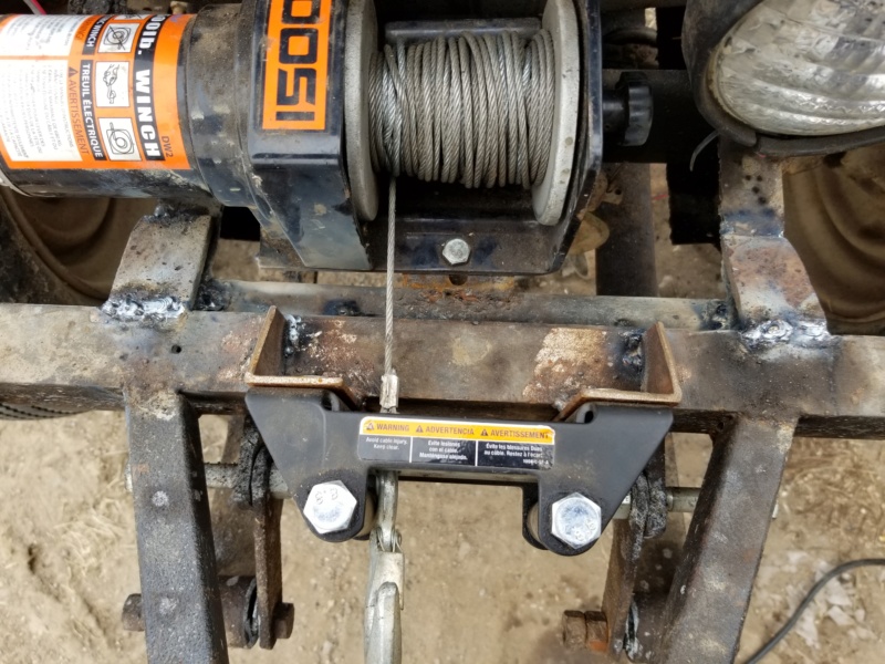

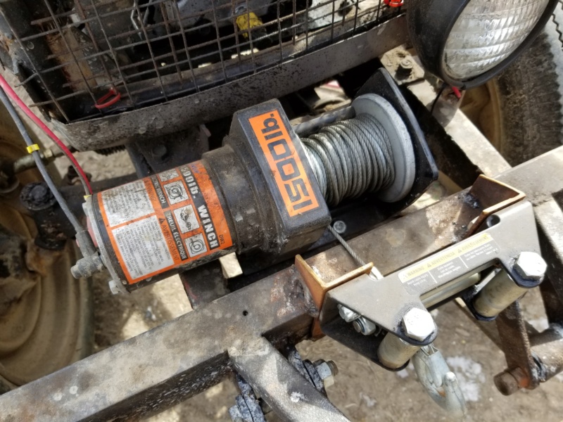

| Well, this is what stuff being frozen to the ground, and one too many reverse gear clutch dumps will get ya:   Yep, LOL. Whoops. Broke the mount. So I cleaned everything up and welded it all a bit better. Then I figured the front mount bar could use some support underneath:  Just a couple pieces of flatstock:  Not the best overhead job, but oh well. Hahaha. Either way it should be stronger now for sure. Added a couple braces up top too for the bumper, while I was in the bracing mood, haha.  Had to learn the hard way this time, but she's all fixed up now and ready for action! Maybe I should quit abusing it a little bit now.  Let me know what ya think! | |

| Only using two of the mounting holes on the winch? Seems kinda unlike you, Allis. Lol | |

| I figured someone would mention that.. It actually only has two holes believe it or not, the previous strap winch of the same make did too. I'm not a huge fan of that particular design, but it doesn't seem to be a problem I guess.
Those flat headed bolts you see aren't mounting bolts, they just hold the planetary gear mechanism to the base of the winch.  "This'll either wake you up or put you to sleep forever!"- Red Green "Whatever you do you should do right, even if it's something wrong." - Hank Hill - MTD Off-Road Build - Ford LT 110 Off-Road Build - Craftsman GT 6000 Off-Road Build - Sears LT11 Rat Rod Build *2019 Build-Off Winner!* - Allis B-110 x2, 710 & 716 - Wheel Horse 655, 953 & 500 Special - Case 444 - Bolens Versamatic & 1668 - Cub 106 & 124 - Ford 120, LGT 125 & 145 - White 1650 Yard Boss *I have 21 tractors and over 40 chainsaws, I need help* | |

| Oh I see. I suppose it'll be ok for 1500lbs, in theory. | |

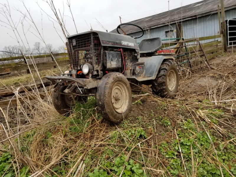

| Broke through a new trail with the ol' GT on the weekend. Got a neat picture of it up on an old foundation:  Big long stretch of trees, she does a pretty good job folding small trees and stuff over to clear a path. Everything held up well, but I think a skidplate or two and a belt guard are in order, haha.  I saw the tie rod take a few hits, so I should probably get at least a front skidplate fabbed up pretty soon. Might be the next project if I get sick of the Build-Off tractor one day.   "This'll either wake you up or put you to sleep forever!"- Red Green "Whatever you do you should do right, even if it's something wrong." - Hank Hill - MTD Off-Road Build - Ford LT 110 Off-Road Build - Craftsman GT 6000 Off-Road Build - Sears LT11 Rat Rod Build *2019 Build-Off Winner!* - Allis B-110 x2, 710 & 716 - Wheel Horse 655, 953 & 500 Special - Case 444 - Bolens Versamatic & 1668 - Cub 106 & 124 - Ford 120, LGT 125 & 145 - White 1650 Yard Boss *I have 21 tractors and over 40 chainsaws, I need help* | |

| - AllisKidD21 wrote:
- Broke through a new trail with the ol' GT on the weekend. Got a neat picture of it up on an old foundation:
I saw the tie rod take a few hits, so I should probably get at least a front skidplate fabbed up pretty soon. Might be the next project if I get sick of the Build-Off tractor one day.  haha I do that quite a bit, let the tractor run over the little shrubs & pricker bushes to make the path, always afraid im gonna get something stuck in a belt or something.... | |

| Yep, haha. This ol' girl is usually the trail maker. I worry about a belt getting thrown off too sometimes, hasn't happened yet though! Hahaha.  "This'll either wake you up or put you to sleep forever!"- Red Green "Whatever you do you should do right, even if it's something wrong." - Hank Hill - MTD Off-Road Build - Ford LT 110 Off-Road Build - Craftsman GT 6000 Off-Road Build - Sears LT11 Rat Rod Build *2019 Build-Off Winner!* - Allis B-110 x2, 710 & 716 - Wheel Horse 655, 953 & 500 Special - Case 444 - Bolens Versamatic & 1668 - Cub 106 & 124 - Ford 120, LGT 125 & 145 - White 1650 Yard Boss *I have 21 tractors and over 40 chainsaws, I need help* | |
