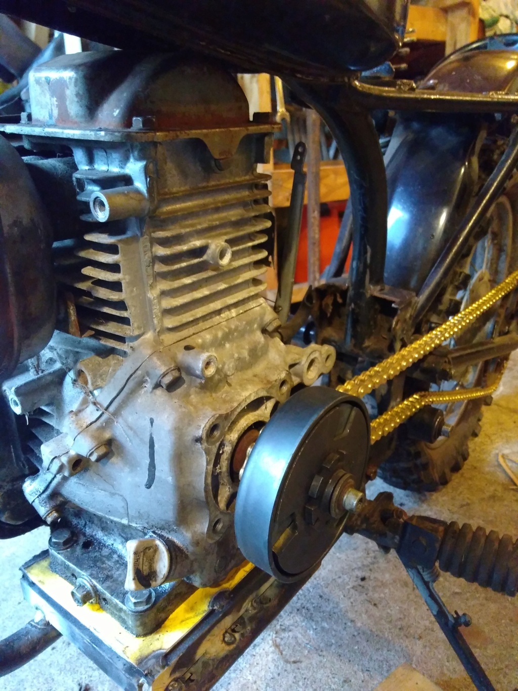

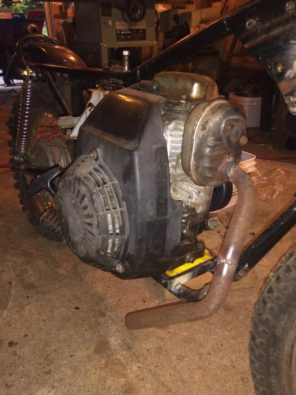

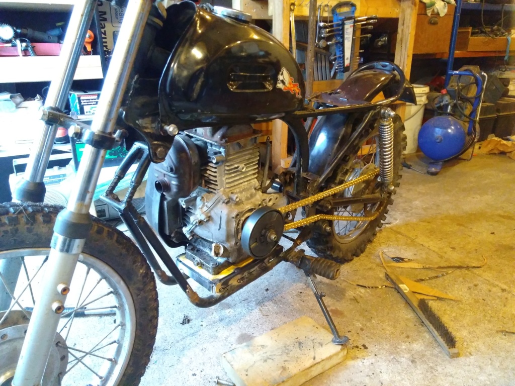

Got the clutch for this thing a few days ago, so I decided to get to work. I welded up the engine plate onto the frame, got a chain, chain tensioner and the clutch on, rigged up this exhaust that I like for some reason, and made new mounts for the gas tank.
pressure washer yammy. Img_2040
pressure washer yammy. Img_2041
pressure washer yammy. Img_2042
Now all that's left is to finish my new intake manifold and get a air filter, rig up some sort of fuel line, and most importantly find a way to make a throttle, which I am not to sure how to do yet. Oh yeah, and also make a seat somehow, but who needs a seat lol.

Nice progress! I actually dig that exhaust you got going on there, pretty simple but it has a real cool look to it.
What are you thinking for an air cleaner setup?

Looking good! Does this thing have brakes?
It does, I might take apart the back brakes and free everything up and hopefully get them working. Too too concerend about the front brakes.
Thanks, I started making a little flange and tube to come out at an angle to replace the stock housing that doesn't fit anymore. I will put a pod filter on it and post a picture when i'm done. I like the exhaust too. I hope its still quiet.

Did you math out the gear ratio? Looks like it would be awful high?
I was concerened about that too. I'll just have to see. I hate jackshafts.

PostSubject: Re: pressure washer yammy.   pressure washer yammy. Icon_minitimeNovember 5th 2018, 6:22 pm
What has you concerned the most about building the throttle?
