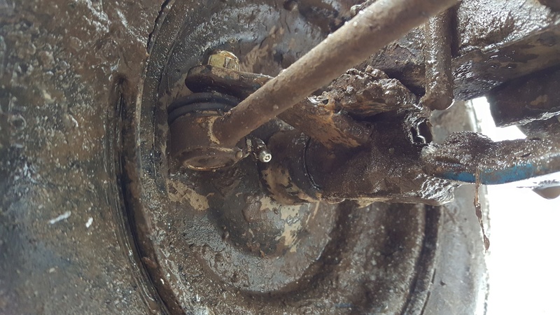

Another little thing, I made up a new tie rod today.
The other one had old heim joint that were a bit wore out and I didn't like the idea of having exposed ones like that getting dirty all the time.
Nice sealed ends!
MTD off-road build (Mobile Terrain Dominator) "2" - Page 6 20180317
They have grease fittings as well, which is nice.
MTD off-road build (Mobile Terrain Dominator) "2" - Page 6 20180318
It has kind of a funny bend in it and I did that so it would clear my steering arm at full lock to the right. Should still work fine.
MTD off-road build (Mobile Terrain Dominator) "2" - Page 6 20180319
It could be bigger roundstock I suppose but it's solid 3/8" so it should do alright. Worst case scenario if I break it I'll throw the old one back on, haha.

Those ends, they sway bar links?

I like the bend in it. It kinda looks cool to me. Nice job. These pictures also give me clues as to how your steering arm angles are set up.
Yessir! Haha, they're pretty handy for stuff sometimes.
Thanks Carl! I kinda thought it looked odd at first but I guess it's not too bad, haha.
biggasmowers wrote:
Okay, something like that would never hold up to the abuse id put it through.
Well the old one was 3/8" hollow and it never broke in all the holes I dropped the front in or all the stuff I've rammed up against. This one should do fine.

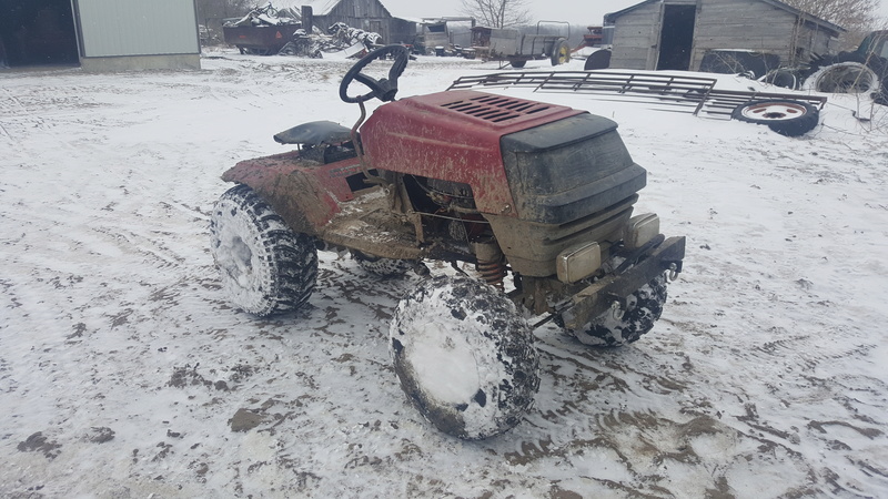

Quite a bit of snow here still so I've been blasting through snow drifts and stuff, which is super fun.
MTD off-road build (Mobile Terrain Dominator) "2" - Page 6 20180325
MTD off-road build (Mobile Terrain Dominator) "2" - Page 6 20180326
Gave the spindle knuckles and tie rod ends a shot of grease afterwards, figured it'd be a good idea.
MTD off-road build (Mobile Terrain Dominator) "2" - Page 6 20180327
Then hit some unexpected mud and got a bit stuck, haha.
MTD off-road build (Mobile Terrain Dominator) "2" - Page 6 20180328
Right I after I got out I broke my pitman arm though, so I'm gonna have to come up with a better design for that. Shouldn't be too hard so I'm not all that worried about it. I definitely had some fun today though up 'til that point! Haha.

Man that mud looks super goopy

Looks like some nasty mud in a nasty surprise! Twisted Evil
Yeah, both tires were loaded in no time, haha.
Oh for sure, I was just crawling around in 1st gear and I felt the back end start to sink out of nowhere, hahaha.
Crazy_Carl wrote:
I'd rather the pitman arm be the weak leak because wouldn't you rather break your pitman arm before your steering box?
That is definitely a good point you have there Carl, haha.
