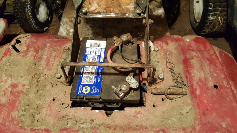

Well a problem has come about that I and I'm sure all of you guys saw coming with the new engine.
MTD off-road build (Mobile Terrain Dominator) "2" - Page 4 20180234
The little battery won't start the engine more than two times in a row, hahaha. So I got a big 540 CCA automotive battery to go in place instead! I figured that'd do the job, haha.
Had to make a new battery tray to drop the taller battery down a bit.
MTD off-road build (Mobile Terrain Dominator) "2" - Page 4 20180235
And after some cutting of the fenders (not near as much as I expected though), it fit perfectly!
MTD off-road build (Mobile Terrain Dominator) "2" - Page 4 20180236
MTD off-road build (Mobile Terrain Dominator) "2" - Page 4 20180237
MTD off-road build (Mobile Terrain Dominator) "2" - Page 4 20180238
Sooo much better! The ol' oppy winds over to beat hell now, shouldn't have a problem with it even with my lights on the front. Pretty darn happy I did this, haha. Let me know what ya think!

Turned out rather nicely I think .

Very nice man. I'm loving the latest round of improvements you've done to this tractor. Now you need to make a cool new romp video.

Thanks biggas! It was actually an easier swap then I expected, haha.
Thanks Carl! Yeah, I would love to have some sort of camera mount setup so I could make some better romp videos. Have to make something like that soon.

Good job, but I would keep an eye on that. I've got a 230 built2015 in Red and I can crank on that thing for a while.
Your big one goes dead, check that charging circuit.

Yes, but the old battery was only 150CCA, so I'm almost positive that was the problem, hahaha. Also I'm pretty sure my charging system works pretty good because I can run my lights for a long time and it hasn't killed the battery. It just didn't quite have the output to crank the ol' opposed over, haha.

AH, I didn't realize. She needs more POWER!!!!
