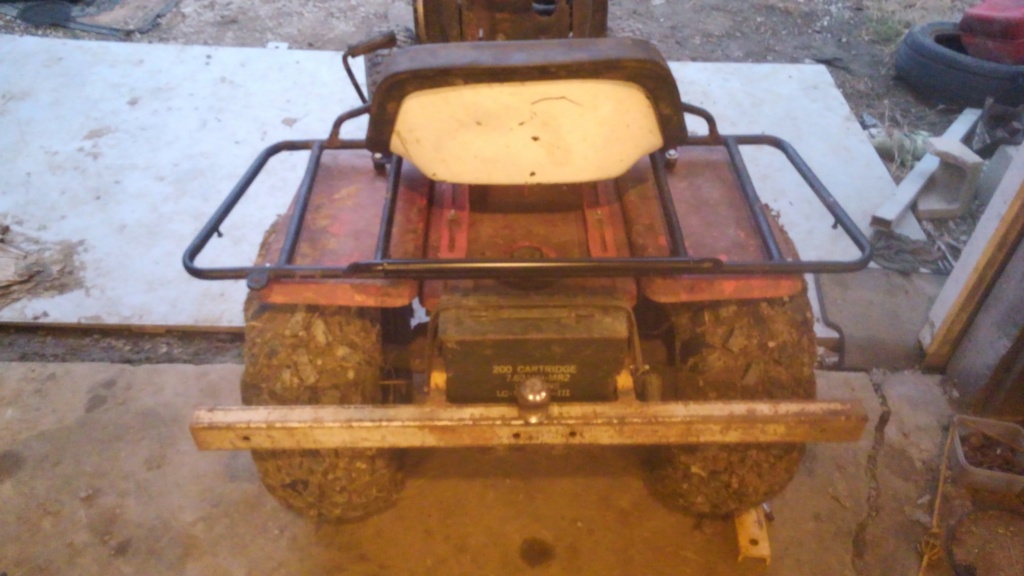

Something new has been added!
This is the front rack from the ATV that i got the rack for mutt from. I liked how it flared out similar to the fenders, but didn't like how narrow it was, so i chopped it right down the middle.
MTD - "Budgie"  - Page 15 Kimg2211
MTD - "Budgie"  - Page 15 Kimg2212
You can see in the pics i used ½ pipe drilled out to match(approximately) the OD of the tubing on the rack. Slide the pipe over the rack, get it about where i want it, tack it, so on so forth. The front side of the rack needed about ¾" standoffs to level it with the fenders.
I'm pretty satisfied with it. It solves the issue I have of the flimsiness of the fenders and gives me good handholds to manhandle her if need be. I honestly don't even intend to carry anything with it.
