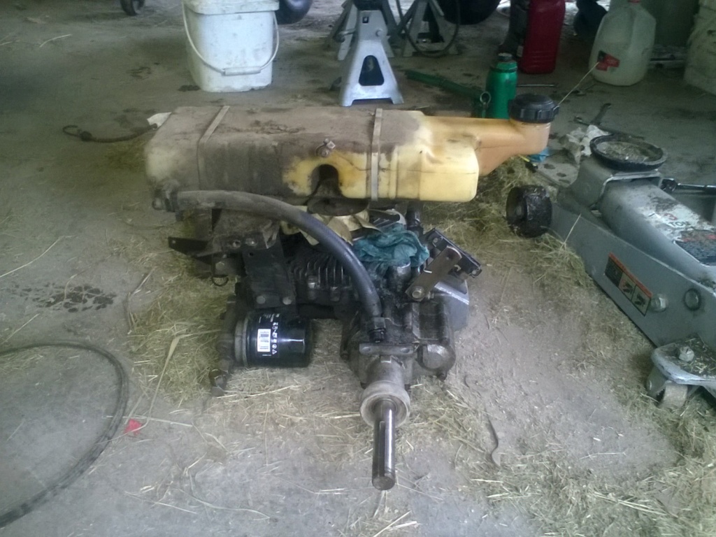

| Transmition and Frame update! Its all out! so it took me about 3 days to get everthing out, and i need to order $60 worth of broken parts, fan, bushings, etc. but the hydrostatic trans is definetly staying in this build, more rust than i wanted to see, but enough that its not a major problem. i am going to repain it, its getting new stickers all around, and its getting a new seat. otherwise enjoy the dissasembly photos  here is the frame with only the hydro lift, and trans left on it.  this is the "power pack" of the ford it has the hydro resivour it is around 2 gallons, and it has the Eaton 850 transaxle. i dont have the exact model of the eaton but i do know that it is the heavy duty model bc, of some extra spacing of axles and the 1inch axles instead of 3/4.  here is 1 of the 2 boxes of parts this box has all of the steering and seat-pan parts, the other box has all of the linkages to everything, brakes, hydro foot petal, etc. more photos and cleaning to come soon! | |

| That trans looks like a good unit. Nice that it has the spin on oil filter, that's always a sign of a good hydro. _______________________________________________ "This'll either wake you up or put you to sleep forever!"- Red Green "Whatever you do you should do right, even if it's something wrong." - Hank Hill - MTD Off-Road Build - Ford LT 110 Off-Road Build - Craftsman GT 6000 Off-Road Build - Sears LT11 Rat Rod Build *2019 Build-Off Winner!* - Allis B-110 x2, 710 & 716 - Wheel Horse 655, 953 & 500 Special - Case 444 - Bolens Versamatic & 1668 - Cub 106 & 124 - Ford LGT 125 & 145 - White 1650 Yard Boss | |

| i had to print off a 80 page manual for the trans just to understand it. there is no differential in it so im at a loss on how to make it have a locked diff, ive experimented with its manual blowoff valve, so i think there is a way to adjust it to work without its differential properties. (if that makes any sense) | |

| hmmm, IDK I wouldn't tamper with the hydro, just routine stuff like changing fluid and filter. You don't want to cause it to overheat. | |
