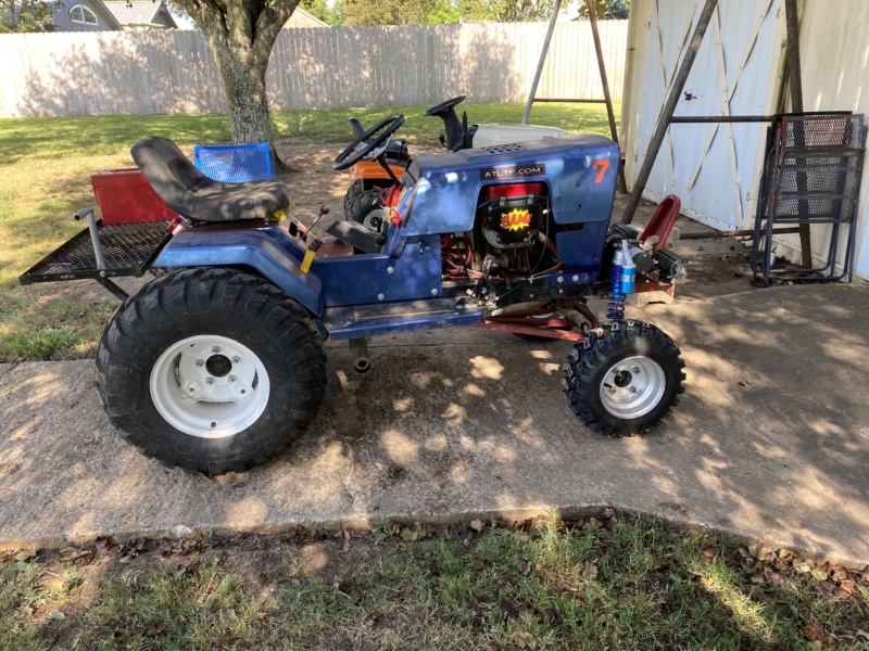

| Nothing much with Kal since I put on the sleeve hitch. Sometime I will take that off and put it on Thor I think. Put the Back rack back on. CQ was right. It was pretty handy at Haspin, not just for the ammo box storage, but made a good seat when just chillin. The old tractor has come a long ways from this...  To this...  | |

| Yeah I'll bet. I'm gonna put a rack on the MM20. I find it rather hard to carry my 5 gallon tank to a tractor that ran out of gas. Not to mention a shotgun.  | |

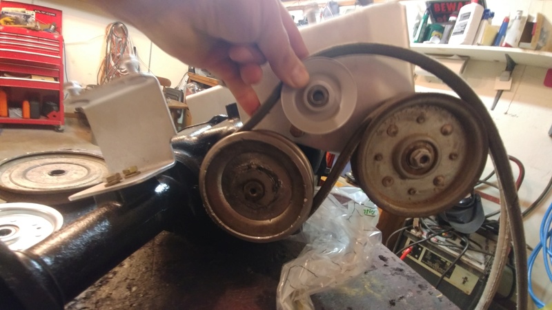

| Wow, has it been that long since Kal was driven? I haven't been too happy with Red lately, so I busted Kal out of the shed. Not sure how with the fuel shut-off being turned off, but Kal has 4x too much oil in it?!?! Draining that out. Pretty black too from Haspin still. Time to freshen it up a bit and have it ready for some possible snow on Wednesday. Kal will have sled duty this year. @Doug posted some of his Haspin footage from last year on YouTube and it reminded me of 2 issues I had. 1) I kept popping out of 2nd gear (think my leg was hitting it). 2) Had to shift a lot as 3rd was too stout a gear to climb hills. (possible not confortable yet with tractor on the trails). So I either need to do one of a few things. ---A) Find a bigger motor (love to have a 20hp pressure lube) ---B) Bigger transaxle pulley. ---C) anything else I come up with. Amazingly enough, I only lost the belt 2 times while at Haspin with the belt twist. I probably would have lost it more If I could have stayed one more day. Both times I lost the belt on pretty serious frame flexing. So some frame bracing is in order. Haspin 2020 at first was a no go for me, but now there is a small possibility to make it. With that in mind, I would like to make a few changes. 1) Frame bracing 2) Thicker belt, I was running a 1/2 when I think I should have had a 5/8. 3) I don't have all the parts, but I may consider the 90 gearbox. It may take out the twist, but it would introduce more belt slip possibly. It would probably be cool, but a horizontal opposed would look nice in there, with the breather busting out the hood. LOL, but that would take almost a complete overhaul of the tractor.  | |

| Maybe keep the belt twist. Run the belt twist to a jackshaft, then the jackshaft to the transaxle. On the belt twist part, keep it tensioned to the jackshaft. Put the clutch on the belt from jackshaft to trans. | |

| I like the belt twist. One belt is less fuss. Just need more keepers.  Head Forum Administrator ** Chat Moderator ** Facebook Page AdminATLTF Facebook Page ** Chatbox ** How To Upload Pictures

| The belt twist has held up well. The issue I think is the small idler I added to help keep the belt aligned. A) The "V" is for a too small a belt. B) I think it is also about 1/2-1 inch too small around.  I believe I do have a replacement idler for it, also one under the tractor need replaced too. There is one noisy idler under there somewhere. (Be awesome if it were the one to be replaced.) | |

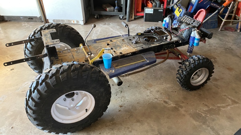

| Not being able to do Haspin this year got me thinking about repairing the ol' tractor. First thing, I robbed the rear tires off Patriot. (I will admit, it's slowly loosing parts now the 9N has kind of replaced it) Talk about a tight fit. As you can see, it has Red's old fronts. Attached the booster and it fired right up.  It seemed to run OK to the garage.  Little hard to turn with the little fronts. So, this is what I have observed and need a fixin...
- oil change, it had 2x capacity. Lots of gas in the block even though I have a shutoff
- probably needs a carb kit
- valve job
- new head gaskets
- upgrade tail lights?
- if $$ is ok, maybe new fronts.
- Not sure I like the frontiers on the rear.
- Air filter, one on it was robbed.
- possibly a new exhaust.

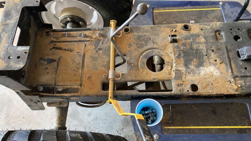

 | Subject: Re: KAL the Extended Journey. June 8th 2020, 9:23 pm | |
| That escalated faster than I planned. Engine gasket set on order as well as a carb kit.  I'm gonna cut those top braces back off of the rear rack and redo where they can be removable.  Lots more dirt than I expected. With everything off, I was able to inspect the belt twist. Yeah my little idler to bring the belt up higher is a major issue. Surprised I only threw my belt 2 times at haspin last year. That will be changed out. I am also going to possibly step up the drive pulley to a 5". Engine pulley has a fair bit of rust on it as well. May need replaced. | |
