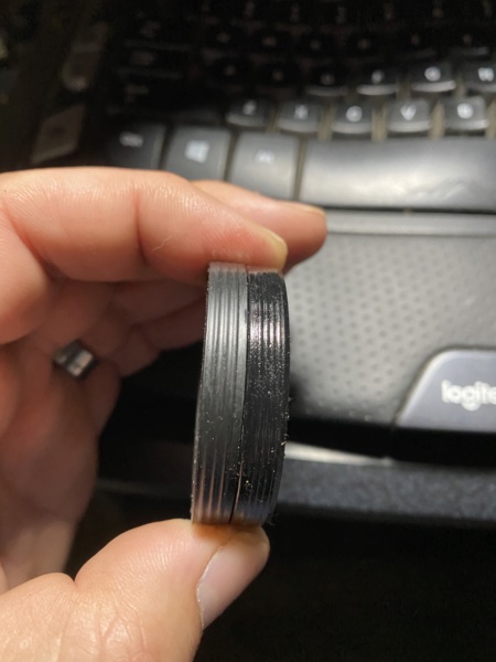

| Suspicions seem correct. It’s about a 16th smaller diameter and almost a 32nd thinner. Also the ridges on the edge are almost smooth on the china one. Won’t be making that mistake again.   Also there wasn't a spring in the china one like the briggs one as you can see. | |

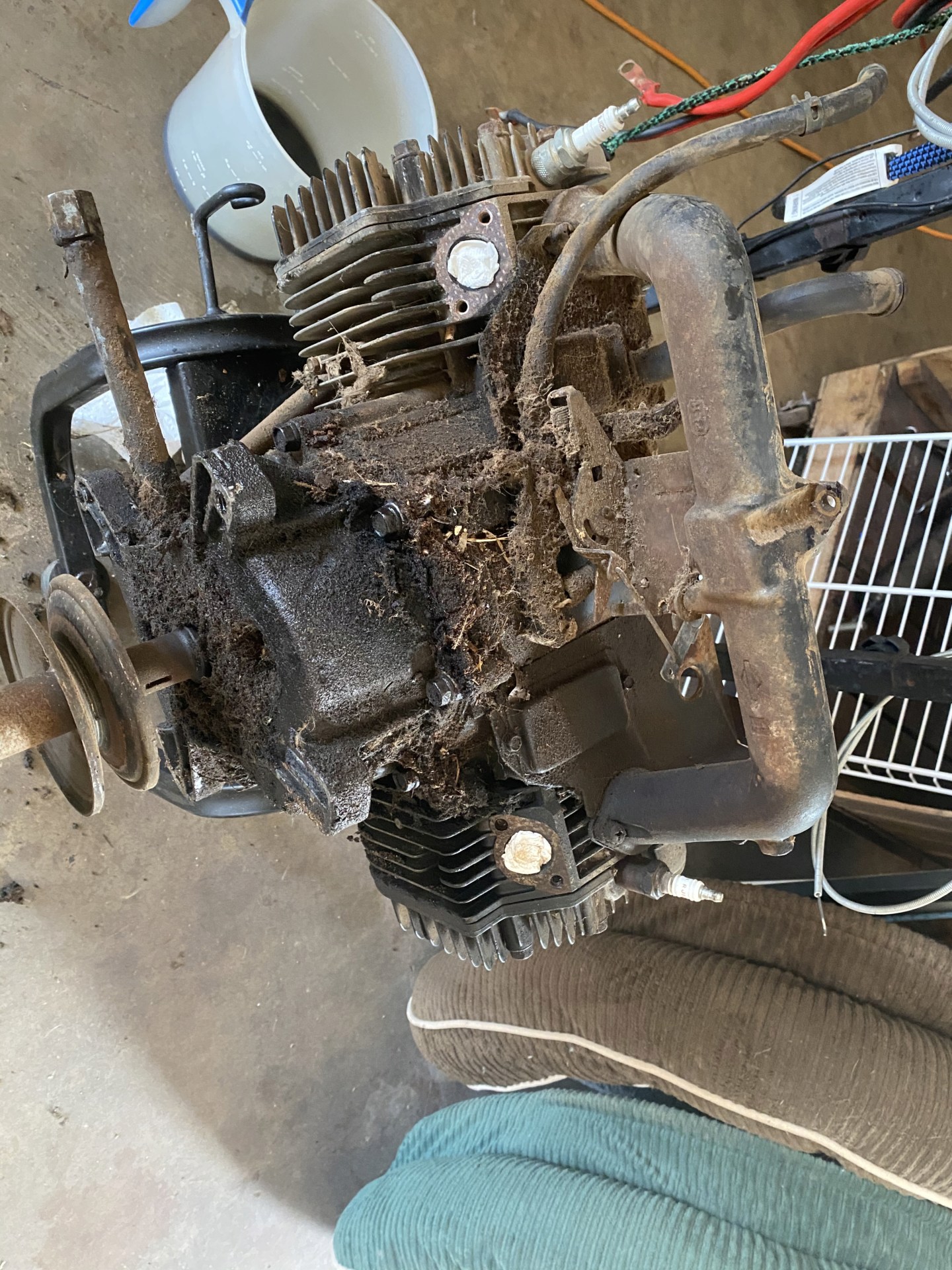

| Cleaned up my parts 18HP. I think I have enough parts to get it going. Initial observation shows it needs valve covers resealed, a new sump gasket, and possibly the rear access port resealed. I have a new sump gasket. Not sure if the bottom seal is bad or not. Preclean:    Post cleanup:  What I need to make it run besides what was listed above. Stator, Carb and Coil. The coil looked cracked. | |
