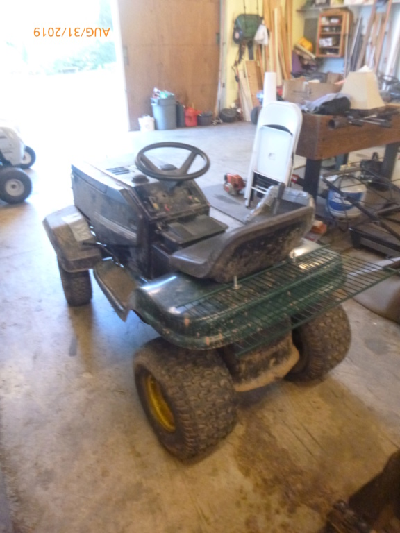

| Well, been working on this since Sunday afternoon... School takes up most of my time, but I'll have it finished tonight! So as you know the Craps-man is dead, so the body is now going to this... That's right, a body swap! It went from this:  To this:  So after cutting this out:  I thought it'd look pretty good. It's not as high as it will really be in these pics, but it looks meant to be:   Then the next day (yesterday), after removing the floorboards, I cut all those tabs out of the shifter's way:   Then I cut a space for the clutch pedal:  And then, after cutting the MO area out of the body and a little too much of it, I could fit the battery and the body in place permanently. I do wish there was more meat in the back, but it fits like it was made for it:  Plenty of clearance:  The front is mounted, but I'm still working on the rear, the seat is gonna give me some trouble if the shifter doesn't. I still have to remove the "CRAFTSMAN" stickers because, well, it's not a craftsman  . I'll be using the original junk Murray floorboards. Anyway, it's comin' along great. I also plan on putting a rack on it now.   | |

| Looking good. Watch out for jagged edges around the shifter. Some people get ramming on the shifter and get cut on the edges. Nice front fenders! | |

| Look at you with the fancy Craftsman fenders now! Looking good. | |

Thank you. Them front fenders could do a better job at keeping the mud off, but it should be an easy fix. I ground down all the edges, and I'm putting the original cover back on, so I'll be plenty save from that! - Destructive wrote:

Heh, I must admit I do like the looks.    So, I mounted it this way so I can mount the rack to the same bolts, and then mount it to the sides of the frame to make everything more sturdy... And, in this case, I like using round headed bolts...   I also like the way the seat looks... Could be more comfortable, but it's good enough.   Can't wait to get it in the mud! | |

| Looking like a little Jeep with the front fenders! Are those sockets that are spacing up the rear fender pan? _______________________________________________ "This'll either wake you up or put you to sleep forever!"- Red Green "Whatever you do you should do right, even if it's something wrong." - Hank Hill - MTD Off-Road Build - Ford LT 110 Off-Road Build - Craftsman GT 6000 Off-Road Build - Sears LT11 Rat Rod Build *2019 Build-Off Winner!* - Allis B-110 x2, 710 & 716 - Wheel Horse 655, 953 & 500 Special - Case 444 - Bolens Versamatic & 1668 - Cub 106 & 124 - Ford LGT 125 & 145 - White 1650 Yard Boss | |

| Shhhh! Don't let everyone know how I use my tools..... LOL, yep, sockets.
Yeah the Jeep look must be why I like it so much! | |

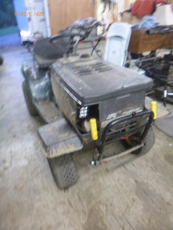

| LOL, I use sockets instead of spacers from time to time. Well, I've pretty much completed this project! The "junk" rack is on.  All in all, I think it looks pretty good!   Some future possibilities: -Bigger and better tires -New seat -Exhaust -Locker -Better pulley swap All depends on what the owner wants... But for now, I like it! Stamped frame update 9/1/19. Sorry for the stupid sideways screen... Something I forgot to mention in the video, the belt always being engaged fixed itself! | |

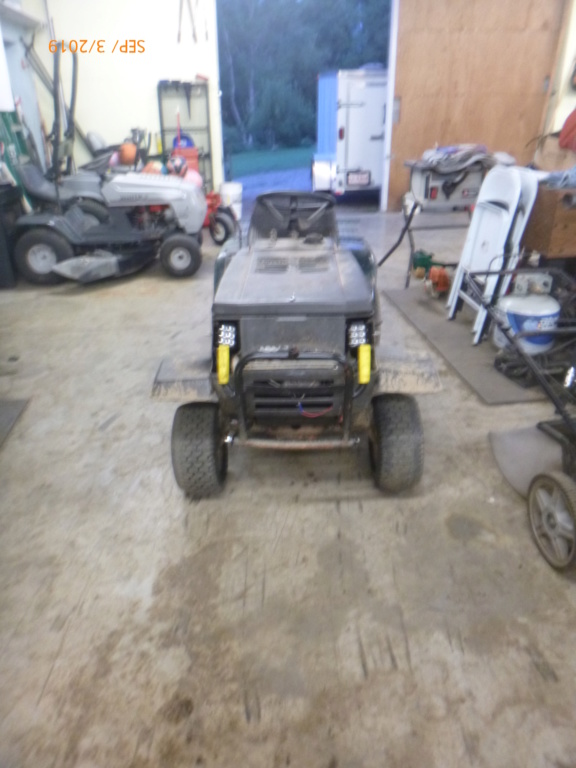

| Well, since I've completed it, it's been constantly breaking things. First the throttle, luckily the Craps-man's old motor had a new one...  Then the headlights fell out, so I mounted them a better way... Alot brighter too.   It's come a good ways from 15 months ago...   | |

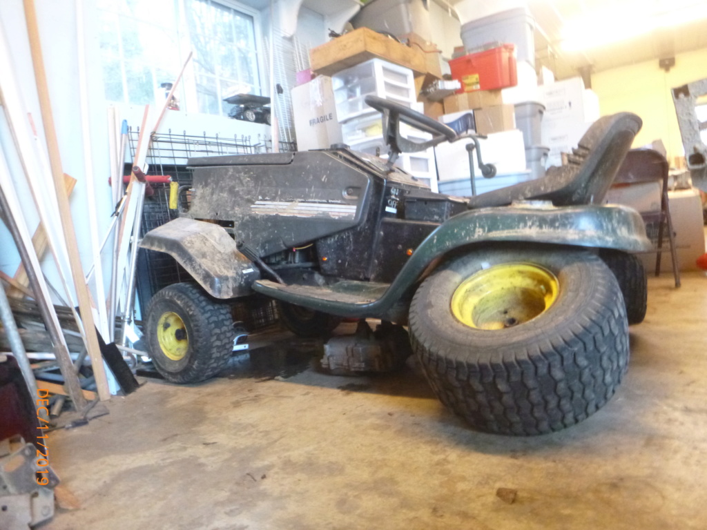

| Going off my last post... This was not supposed to happen. Front wheel was stopped by a rock, forcing me to back up the hill. Well it didn't want to go up the hill, so it slid sideways. Luckily I got it back out without tipping it.  | |

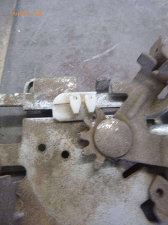

| I could beat my head against a wall right now and enjoy it. After using the ENTIRE thing of RTV, I went to put it together and it wouldn't seal, then the shifter ball fell out. Had to take it back apart and ruin the seal. Now that it's together, the axles don't spin, the input shaft is hard to turn, and I'm almost sure it will leak. I can't take another leaky trans... I'll go crazy. All I can say is we'll see what happens. Still need brakes, a c-clip, and have to find the belt...  ! Anyway...  Had some bad rust on the shifter shaft (or whatever that's called)...  Also managed to snap off a bolt in the case. Thanks to my master drilling skills I did this...   Should seal perfectly. Finished the tires...  More to come... | |
Age : 47 Join date : 2016-09-06 Posts : 8500 Location : Oklahoma
 | Subject: Re: Murray Stamped Frame December 13th 2019, 11:48 pm | |
| Sounds like a bronze bushing is out of square. _______________________________________________ Tractors: Li'l Red - 89 Murray Widebody TheGreenMachine - 89 Craftsman GT18 Bowser - 01 Murray Widebody LT Phoenix - 75 Sears ST/16 Dirty Rat - 77 Sears Suburban Kal-El - 82 Murray GT Have a question? Ask me! Type in "@MightyRaze" in your post! | |

Yes. That's why it didn't go together on the first try. Got it together now and the spider gears won't even work. Won't roll or anything. It shifts, the input turns, but it just won't roll. It'll have to come apart again obviously, but I have no idea when. I can't take the chance on driving it... I just know it's gonna blow. Too bad it only needs gas lines, the engine pulley, and the belt and it would drive if it wasn't for this problem. I put the oil and everything in cause I thought that once the oil got in the axles, it would free up. Guess I was wrong. I had to drill a hole in the side of the case to fill it up. There was no drain/fill plug. (sorry for the crappy picture, looked better on a smaller screen.)  Sure does suck that it's on 4 wheels but ain't gonna drive. I think the spider gears didn't seat properly or something. There was also a spot on the case where it didn't compress the RTV. Same place the MM's bolts stripped.  So I don't about you guys, but...  | |
