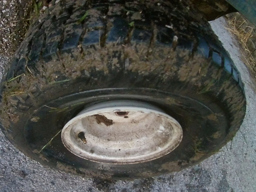

 | Subject: Re: 98 craftsman lt1000 Mudder/trail rider Fri 16 Aug 2019, 3:27 pm | |
| took the it down the road last night about a half a mile to ride in some shallow mud only got stuck once surprisingly but after the drive there i realize how much i need a pulley swap on this thing anyways heres a slightly muddy pic of it  | |

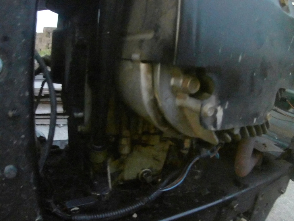

|  finally got a rack built up for the back of this thing used stuff laying around and some bolts still need to make braces running down to the frame but for now its not that big of a deal as the most itll carry is 50lbs  another picture from the front  then this happened to me in the middle of a field and it was on my main drive side so i had to push it home  also decided to make a hood hold down since it was bouncing around like crazy [url=https://servimg.com/view/20075183/13]  [/uraa a few days ago i discovered that this thing was leaking oil around the dipstick tube any ideas of where it could be coming from and how i can fix it for the most part it seems like its on the side of the engine not the ground at all | |

| Oil leak is probably the seal around the dipstick tube. Pretty easy fix. That atv box is pretty neat too, but i agree it’s a bit big for the tractor. Maybe on a craftsman GT or something | |
