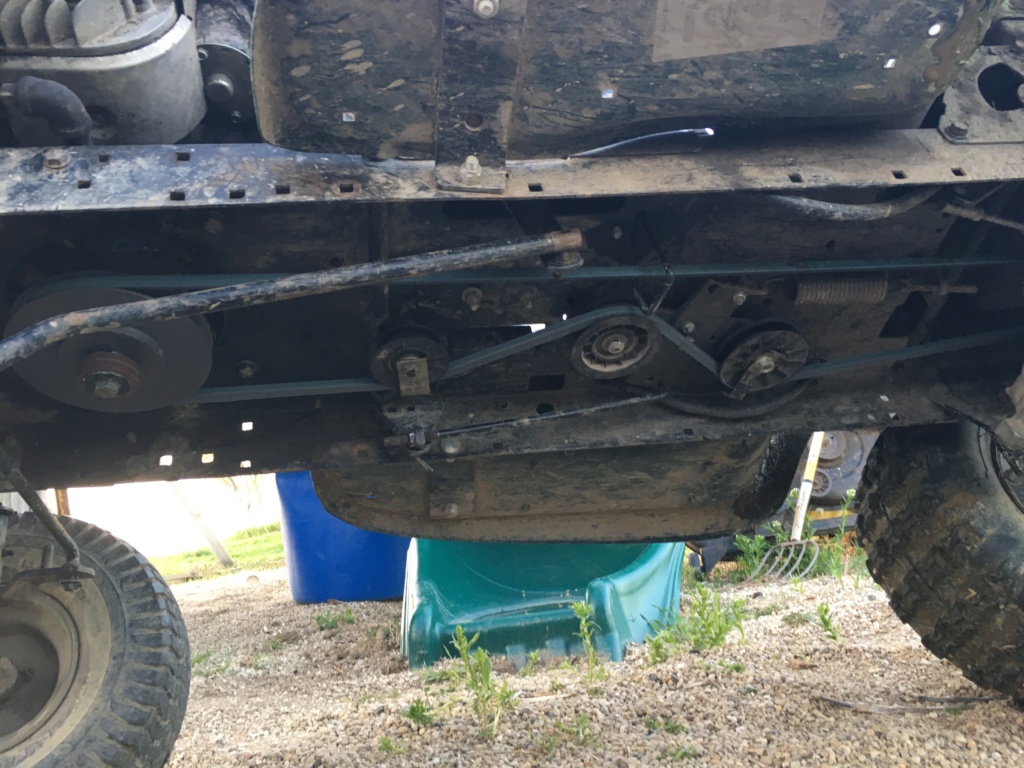

| Any obvious things on the outside? It could just be the pulley spinning on the shaft. Check simple stuff like that before you tear into it. | |

 | Subject: Re: 98 craftsman lt1000 Mudder/trail rider April 16th 2020, 1:16 pm | |
| Alright so I’m finally sick of this trans so I’m gonna end up taking the plunge and putting my money into a doc locker on this so hopefully I don’t have to go through this again | |
