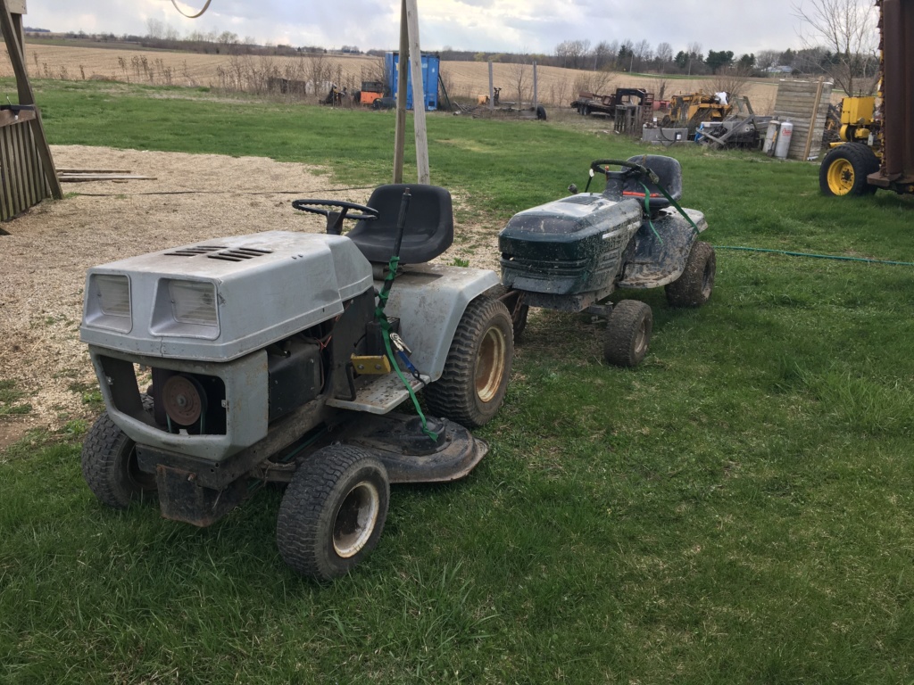

so this wasn’t the update I was planning to make but I think I blew the trans AGAIN. So a couple of days ago I finally got it home after welding the diff and a few other things and had it to the point where it was working almost perfectly so I decided to take it out into the field to do a little bit of mud riding with it. I plowed into a mud hole and got stuck so I was backing up but in the middle of backing up it stopped moving and I looked and the belt was still on the proper way but was just spinning on the pulley in all gears including neutral but it was still rolling in neutral so I had to push it a bit. Anyways it’s back home now and I guess imma look at it some more sometime this week hopefully.98 craftsman lt1000 Mudder/trail rider - Page 5 A4182810
Ended up getting the j hook and dragging it home with this beast that I recently got, a build thread on it is coming once I get the green craftsman going the way it should
Points : 6181
Posts : 3390
98 craftsman lt1000 Mudder/trail rider - Page 5 Empty
PostSubject: Re: 98 craftsman lt1000 Mudder/trail rider   98 craftsman lt1000 Mudder/trail rider - Page 5 Icon_minitimeApril 15th 2020, 7:03 pm
Any obvious things on the outside? It could just be the pulley spinning on the shaft. Check simple stuff like that before you tear into it.
