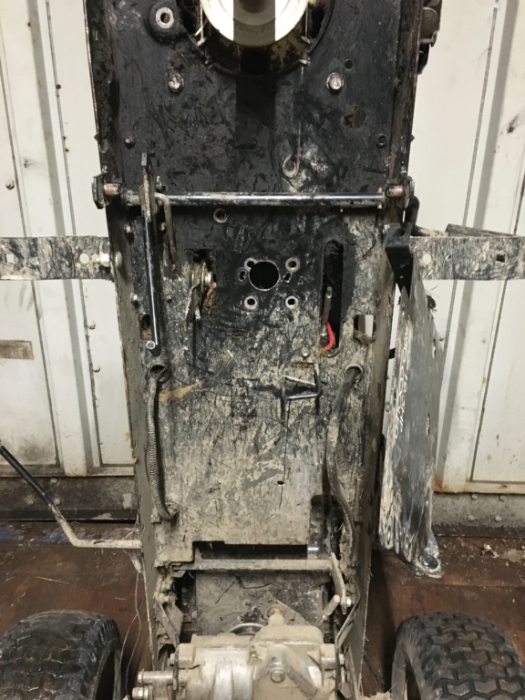

| well today I got the main part of the clutch done now I just need to rebuild the clutch and the linkage any ways you guys think that I could improve it  | |
CraftsmanQuad19 Core Member
 | Subject: Re: 98 craftsman lt1000 Mudder/trail rider December 24th 2019, 6:02 pm | |
| Putting the clutch pulleys closer together gives them more leverage to pull the belt tighter | |
 | Subject: Re: 98 craftsman lt1000 Mudder/trail rider December 24th 2019, 8:41 pm | |
| You’re welcome. That was the only thing I could see from the pic that would make much difference | |

| So the time has finally come to update you guys on what I’ve done with this. The first thing I did was make a double pulley clutch thst works with my stock clutch linkage, it works well but I need to make a couple belt guards and I plan on replacing the spring with a stronger ad justable one I have that’s from a Murray. So far it works pretty good but I feel like I could eliminate most of my belt slippage with a stronger spring. The second thing I did was swap the old steering box out and put a new gen 1 steering box in that works surprisingly well for what it is The third thing I did was swap in the locked mst 205. I was planning on running bearings in the axle shafts but the ones I was told to get (6203) ended up being the wrong size so I left them out. To lock the transaxle I decided to use extra spider gears due to me not having a welder. I also drained all the fluid from the case and refilled it with some 90 weight we had in the basement. The mst ended up having a longer shifter rod so I had to add an extra idler pulley and bend my shift linkage so that it would work with the higher rod.  Here’s the problem I was having And here’s how I put the idler in to hold the belt off the shifter rod While I had it apart I ended up putting the atv tires on the back and also blacked out the headlight lense since I plan on adding a light bar So here’s my current to do list for this this thing Atv front tires and rims for the front of the tractor Adjust the shift linkage some and grind away part of the fender so I can reach 5th gear New grille since the current one is split in half and held together by zip ties Have my dad weld up a front bumper for this thing Remake The rear rack so it has more support and can hold more stuff Rewire it so I can get rid of the safety switches Make a gas pedal and run it ungoverned Paint rims black Replace the clutch spring with a stronger one Add a light bar onto the bumper Setup a quieter exhaust instead of open headers like I have it now Make a few belt keepers for The pulleys And maybe make a roll cage for the engine so it won’t get messed up in case I roll And after those are my plans for phase 2 of the build, anyways leave any suggestions or changes that you would make to it. Here’s some pics of the test run I had with it today just around the yard, it does surprisingly well In mud, and managed to haul a couple hundred pounds of blocks pretty good    | |
 | Subject: Re: 98 craftsman lt1000 Mudder/trail rider February 24th 2020, 12:15 am | |
| Nice work, looks like you're having fun.
One suggestion I would make is to change the idler setup to push the belt the other way around the shifter shaft. The way it's running now will greatly decrease the surface area of belt on the trans pulley and cause belt slippage. If you have the belt on the other side of the shaft and use a flat idler to push it towards the clutch, you will have better belt grip and it will still clear the shifter shaft.
