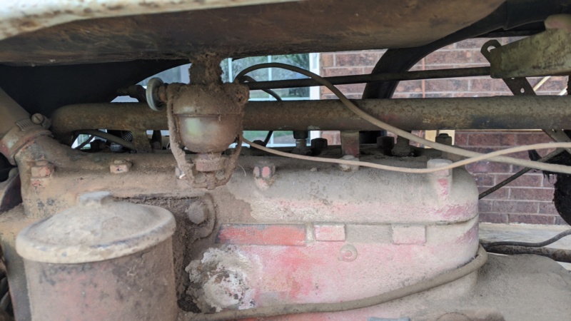

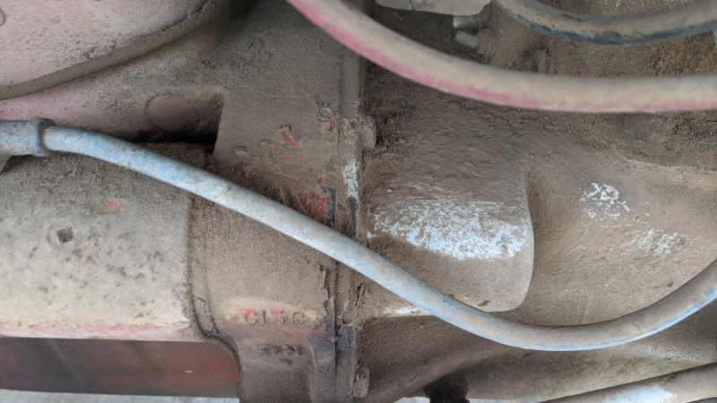

Here ya go... she's a flatty.
Larger Tractor 9N Img_2314
You can see where the 8n (RED) was mated to the 9n rear (GREY).
Larger Tractor 9N Img_2315
First thing this old girl needs a good scrubbing.  Then it needs the shift selector installed in the trans.  From there, I'll give her the flame juice and fire it up.

PostSubject: Re: Larger Tractor 9N   Larger Tractor 9N Icon_minitimeMarch 13th 2020, 6:44 pm
My grandfather's has the exhaust manifold rusted off for quite awhile. Like someone said, the old 6v system cranks kinda slow. But it gets her going.

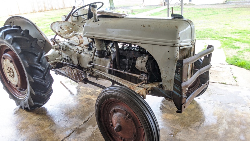

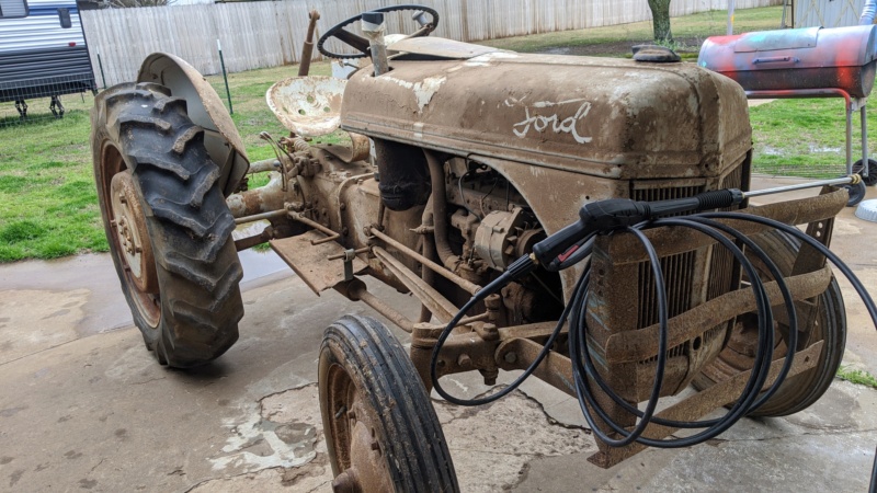

All cleaned up, now to perform a couple fixes then see if it will start.
Larger Tractor 9N Img_2316
Larger Tractor 9N Img_2317

PostSubject: Re: Larger Tractor 9N   Larger Tractor 9N Icon_minitimeMarch 14th 2020, 7:01 pm
Ah, it's really not that bad on the outside now that it's cleaned up. I like that "Ford" logo. LOL.
Points : 8228
Larger Tractor 9N Empty
PostSubject: Re: Larger Tractor 9N   Larger Tractor 9N Icon_minitimeMarch 14th 2020, 7:10 pm
Hmm, is there any chance the ol' girl has been converted to 12v? Just wondering because of the alternator on it.
Looks like she cleaned up nice.
