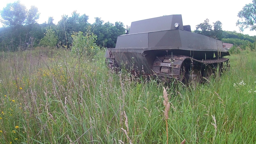

| NICE!
Side muffler is pretty awesome too.
Pretty much I think this is one of or the best home made tracked vehicle I've seen online. Body and suspension are nicely done and the tracks don't fall off. Not only that but they look professional and they're not complete hack jobs. Nice deal! | |

| Just a little bit of closure on this project. For the year I am finished with the tracked machine to work on other projects. It achieved the majority of things I wanted in my first amphib tracklayer. Low ground pressure, high drawbar pull, floating capability, spacious vehicle deck, easy to build, rugged, and built from economical common car components. Likewise, it starts every time, goes forward, backward, steers, kinda swims and has never left me stranded that wasn't operator induced. So with that the "Drunk Frog" bids you adieu! | |

| You need bigger grousers on the track if you want it to swim better than "sort of". Any track with short grousers doesn't swim very well. Taller grousers will also give you better mud performance, but will make any hard pack running pretty rough going on the occupants. Especially at any significant speed. Water speed and land speed are always a trade off with amphibs. There's also some water travel speed to be gained with some fender work to "scrape" water off the tracks as they travel forward. Any water thrown forward works against moving the vehicle forward. Newton's 3rd law is getting right in your face with that one..... I use an outboard for my Argo (whether it's on tires or tracks) if there's any long water crossings. You may want to consider adding one (long shaft, like those used on sailboats), or at least a spot for one to be hung. You certainly have room for it! | |
