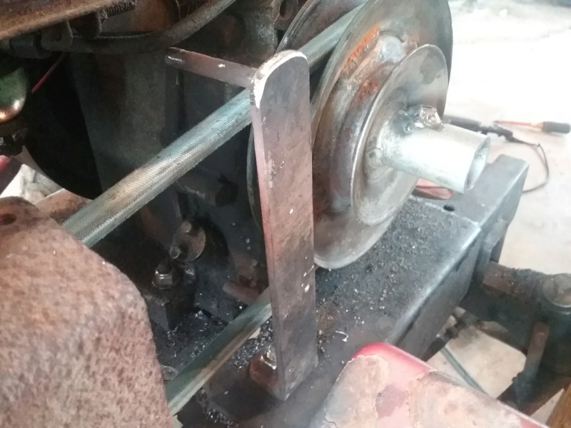

| Put the new belt on and moved around the one idler. The belt really doesn't like to slip, but i think it all will wear in.

- The belt really doesn't like to slip, but i think it all will wear in.
I'm not really sure what you mean there? Could you elaborate? | |
Age : 21 Join date : 2016-10-29 Points : 6601 Posts : 3628 Location : Lewisburg, KY
| Subject: Re: MTD - "Budgie" August 1st 2018, 9:52 am | |
| The belt doesn't like to stop when i push the clutch, unless it's in gear | |

| Subject: Re: MTD - "Budgie" August 1st 2018, 1:14 pm | |
| Little stretching and polishing the pulleys (break-in) and as long as you have some guides. Should work out. Hopefully the belt doesn't get chewed up. | |
| Subject: Re: MTD - "Budgie" August 1st 2018, 1:21 pm | |
| I haven't had a problem with the belt coming off. Might put some guides anyways. | |
Age : 49 Join date : 2016-09-06 Points : 15056 Posts : 10634 Location : Oklahoma
| Subject: Re: MTD - "Budgie" August 1st 2018, 2:12 pm | |
| I had to add a couple engine and one trans guide to Kal so the belt would not grab on clutching. Didn't need them to keep it on. | |
| Subject: Re: MTD - "Budgie" August 1st 2018, 2:21 pm | |
| The stock ones are still on the trans, guess i only gotta worry about the engine | |

| Subject: Re: MTD - "Budgie" August 1st 2018, 9:53 pm | |

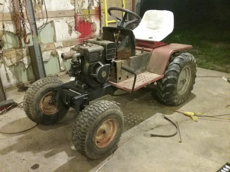

| Made a front belt keeper. With that, it seems the belt problems are solved. I also cut tubing to space the rear wheels correctly so they arent walking back and forth on there. Next... gas pedal, seat, and maybe some work with the front axle | |

| Subject: Re: MTD - "Budgie" August 2nd 2018, 12:44 am | |
| Put the seat from the RS on. Only had to drill 2 holes so that's cool. I also put the shifter thingy in, made a kingpin and put it in, and greased the front end and steering. Probably other things too but i dont remember. (I have the foam part of that seat ill prolly duct tape on, it's not bad now though) Now... reroute exhaust so i can have the hood on and gas pedal. We'll see how it looks then. | |

| Subject: Re: MTD - "Budgie" August 2nd 2018, 2:16 am | |
| The Belt keeper is kinda bit overkilled LOL

| Subject: Re: MTD - "Budgie" August 2nd 2018, 2:27 pm | |
| I like the belt retainer design. Does the stock exhaust not line up with one of the headlight holes? | |

| Subject: Re: MTD - "Budgie" August 2nd 2018, 10:23 pm | |
| Really like the looks of that old engine. | |
| Subject: Re: MTD - "Budgie" August 2nd 2018, 10:28 pm | |
| Me too. Shame it's getting replaced with a honda clone that i wont feel bad about abusing, when i get one | |
