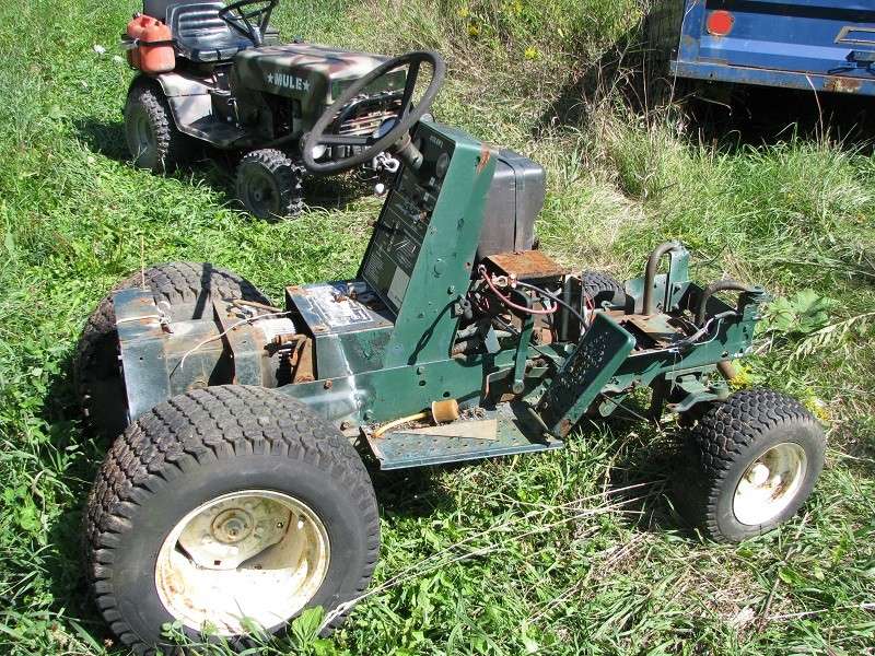

| Well- I've been thinking about and talking about it. Time to take the first step- eyeballing and documenting. First- The starting point. It's a long-dead 1970-something (unsure as of yet) Bolens garden tractor. It's a hydro, and everything about it screams "BEEF!". The frame is quite stout, the front axle is a heavy cast-iron bugger, the hydro transaxle is also cast iron and huge. As big and badass as the hydro is, it's leaving. It did work when parked but I have a driveline idea I want to explore. The original engine is long gone, a previous owner replaced it with a 18hp Vanny horizontal, which has been sitting in my garage. Needed a carb job when parked. The plan: Another Mobile Utility and Light Extrication, bigger, badder, better. Standard features will include MULE's usuals- Bigger more aggressive tires, onboard air compressor and battery boost, winch, tool and fuel storage, etc. What's new? Aside from simply "bigger", the driveline is going to take a major left-hand turn. Briggs Vanny V-Twin 18hp horizontal, Comet 40 CVT, Race-Prepped Peerless 700 transmission, Disc Brakes, Live (go kart) axle. Ultimately, I'd like to make it a tandem, but we will see. I'd like to build a pickup-style bed, and an A-Frame or some other rear load-lifting apparatus. Not shown is the hood and seat (I have them) and the rear fender unit which I reconfigured to go on General Mayhem. Here's the starting point- ****************************************EDIT 03/11/14*********************************** I've decided The John Deere 112 will become MULEII. This project WILL continue, under a different name to be announced later

| I sure would be looking at that hydro to see if you can speed it up. Maybe swap some gears. Even though that is a beefier axle, we have snapped cart iron axles, they can be brittle. | |

| Another frame up. Sweet build plans, when will all the parts be together? | |

| Nah- as much as I am 100% sure that I could drop this hydro transaxle off a cliff and it would live, there's a driveline proof-of concept I am after. I am not planning on getting rid of it, it may yet get used somewhere.
I have the BULK of the parts together- frame, engine, RAGB, Comet40 complete, Peerless 700. I Have an axle with two good pillow blocks, plenty of brake parts and options. I have 2 rear tires and rims that I MIGHT use, and an assortment of front rim possibilities. I checked on the front tires I wanted to use, the rubber's shot. Dang. | |

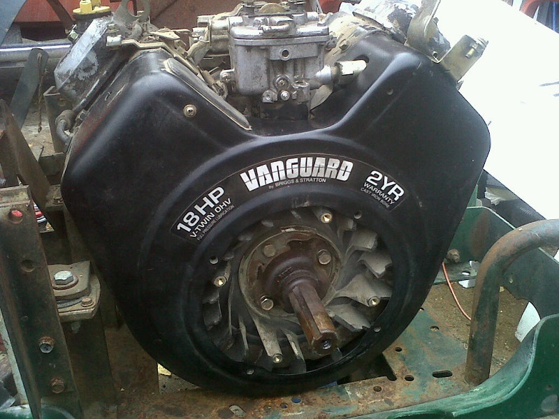

| Gettin' Briggy wid it! A productive morning. When the engine was last run, it was starting to need a carb job. I remember it needed the choke on to run, and then it was mothballed nearly 5 years ago. I tore into the carb this morning and cleaned everything out. Was pretty nasty in there. So nasty in fact, that the anti-afterfire solenoid was siezed solid in the closed position. I whipped out ye olde wirecutters and cut the pin off, as well as the wire. Seeya! Cleaned everything out, slapped the carb back on, rigged a gravity-feed test tank, et voila! Cranked right up, and idled nicely. Bueno. This engine has a few very nice features. 20 amp regulated charging system, full pressure lube system with spin-on oil filter, and an auxiliary PTO shaft on the flywheel side. This is good. If I run into too many clearance issues running the CVT on the "normal" side, I can put it on the flywheel side and order a reverse-wind spring to run it backwards.  | |

| It wont work Doc... Not that twin. It wont do it. Better to just send it to me for proper disposal... lol | |

| PTO O.O more like a easyer way to mount a supercharger setup *HINT HINT HINT HINT* (did ya get that hint LOL ) | |

 | Subject: Re: Planning, Plotting, And Scheming- Name TBA September 20th 2013, 7:10 pm | |
| Y'know... I HAVE been burning braincells trying to figure out what I can do with the auxiliary shaft! Sadly Jay (sorry) I doubt it will be running a supercharger. I might run an automotive alternator, But I'm leaning towards a hydraulic pump. To run what? Not sure yet, but I do have a useful ram... | |
