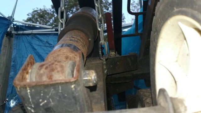

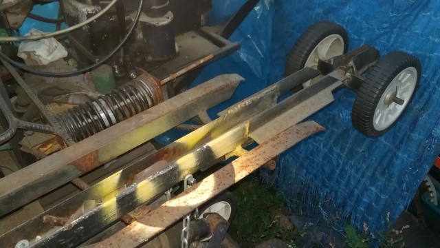

PostSubject: A tiny bit of work   Prancstaman's X1 Scorpion - Page 9 Icon_minitimeMay 29th 2019, 9:42 pm
Hay people,
Did a little work on this thing. Been sitting on the table at the end of my driveway for forever. Just kept it covered. I got some work done early after work today so I decided to work on this. Planned out what I wanted to do ahead of time and had all the parts waiting and just had to throw them on. Just a couple bolts, eyelets and nuts.

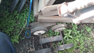

Prancstaman's X1 Scorpion - Page 9 Bogie_11
Plan is to connect the rear bogie to the track tensioner up front. The rear suspension wants to compress more then the front suspension wants to extend, so I'll take advantage of this.
First step is to make a connecting point on the bogie which will be the bolt that holds the bogie onto the A-frame.
Prancstaman's X1 Scorpion - Page 9 Bogie_12
Pull the bolt, got washers inside to space the bogie in the right spot.
Prancstaman's X1 Scorpion - Page 9 Bogie_14Prancstaman's X1 Scorpion - Page 9 Bogie_13
A little test fitting.
Prancstaman's X1 Scorpion - Page 9 Bogie_15
Put them back together.
Prancstaman's X1 Scorpion - Page 9 Bogie_16
Prancstaman's X1 Scorpion - Page 9 Bogie_17
The whole thing took about a half hour. Don't know when I'll be doing work on this next, but still working on it from time to time. Later. Prancstaman's X1 Scorpion - Page 9 2731072446

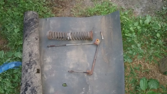

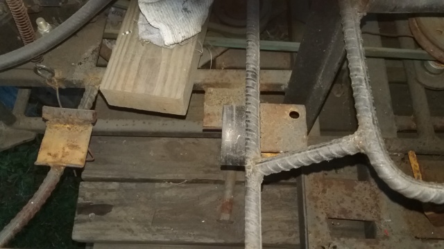

PostSubject: Old track tensioners are off   Prancstaman's X1 Scorpion - Page 9 Icon_minitimeAugust 4th 2019, 9:09 pm
Hay People,
Had a few to work on this, spare of the moment thing. While I'm doing other things, and I finish early, I work on this. Seems only thing doable. So, thought I would need the track tensioners off next. Could use some of the parts too.
Had an all thread holding the spring on and wouldn't you know it, the bolt was screwed all the way in, ok most of the way, alright looks like half way in the pic. But it looked like all the way at the time of doing it.
Prancstaman's X1 Scorpion - Page 9 20190811
After turning the nut for a few, got the idea that there should be a better way. Went to my basement to look at the pile of wrenches (didn't hang my wrench hanger yet, LOL).Got a bunch of those wrench ratchets. Need a 9/16. Dug through the pile. nope! 5/8 and 11/16 on all of them, that sucks!! See my luck. Found some gimmicky wrench that fits everything. Looks like it will suck big time, but better then a regular wrench though.
Prancstaman's X1 Scorpion - Page 9 20190812
Twist it, then turn, then twist, then unturn. YUP!! Sucks!! Unscrewed it though, still not a regular wrench too, LOL.

So I got the parts off. Next, I pulled the front track tensioner wheels and axle assembly off for a quick grease up. And wouldn't you know it, it bit me. The cotter pin/bent coat hanger, stabbed me in the finger. Ouch!!. Put it, let me rephrase that, threw it on the table and greased it up.
Prancstaman's X1 Scorpion - Page 9 20190815

I put it back on, kinda sticking in spots, probably from dirt and rust, so I slide it back and forth to get it working. I then push it all the way in.
Prancstaman's X1 Scorpion - Page 9 20190816
Total time took about a half hour or so at the end of the day. Call it quits till tomorrow. And what I took off.

Next day. I needed to get the weedwacker cutting up stuff and figure if I finish early I can do some more work on this. Half way through cutting, the weedwacker stops running. Get frustrated with it and take a break from it to clear my head.
So I do the other side.
Prancstaman's X1 Scorpion - Page 9 20190821
Prancstaman's X1 Scorpion - Page 9 20190822
That's it for now.

Hay People,
Had some time today, and knew what needed to be done. Knocked it out in a couple hours. I was just going to relax when I got home, nah. Made the next parts which was the swingarms for the track tensioners.
Dug around for some metal, found some square tubing, should work OK but is thin walled. Found some spacers to weld to the bottom for a pivot point. Measured the length. Cut the tubing and welded the spacers on.

The 2 assemblies before I put them in.
Prancstaman's X1 Scorpion - Page 9 20190828
The sun was going down, the bugs were out, but I managed to weld them in, both of them. I only got a pic of the one side, the bugs were buggin and I just wanted to go in for the night, LOL.
Prancstaman's X1 Scorpion - Page 9 20190829
A view from the ground wheels where the linkage will be run, from the wheel area up to the swing arm. I noticed that it's not a straight shot from the attachment point on the lower A-frame up to the swing arm. Will have to notch the A-frame up top there or put a bend in the linkage. We shall see.
Prancstaman's X1 Scorpion - Page 9 20190830
That's it for today. Next is the linkage rod from the lower A-frame up to the swing arm. Will just be a 3/8" rod with bolts welded to it for the clevis's to attach to. The issue that was mentioned will be dealt with when I make the linkage. I just wanted to get away from the bugs tonight.
