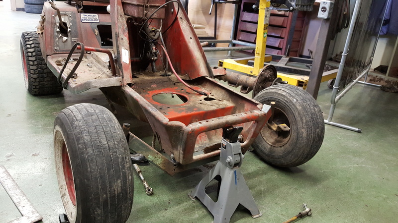

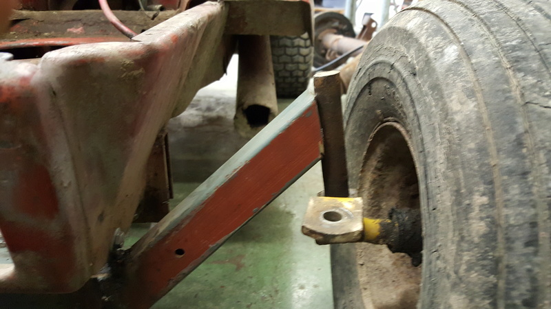

 | Subject: Re: My Rat Rod Mower March 6th 2017, 10:54 am | |
| Well im back to working on the ol' rat rod! I used the old rebar braces from the Sears axle and welded them on to this one.  I think they look kinda cool so I re-used them, plus I couldn't be bothered to make new ones hahaha. They should help strengthen the axle mounting a bit. Also I got my angles cut to start mounting the spindle knuckles!    We're getting closer to being able to roll Again!!!  I'm super exciting to see 'er on the ground! I'm probably not gonna do the bearings for the spindles, as great an idea as that is, but I'm definitely gonna have greases fittings to keep wear to a minimum. Should still work pretty good Stay tuned! _______________________________________________ "This'll either wake you up or put you to sleep forever!"- Red Green "Whatever you do you should do right, even if it's something wrong." - Hank Hill - MTD Off-Road Build - Ford LT 110 Off-Road Build - Craftsman GT 6000 Off-Road Build - Sears LT11 Rat Rod Build *2019 Build-Off Winner!* - Allis B-110 x2, 710 & 716 - Wheel Horse 655, 953 & 500 Special - Case 444 - Bolens Versamatic & 1668 - Cub 106 & 124 - Ford LGT 125 & 145 - White 1650 Yard Boss | |

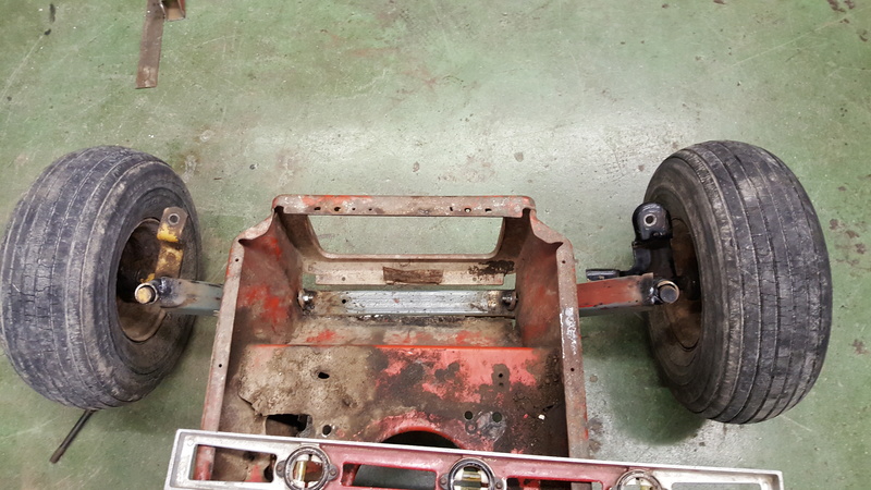

 | Subject: Re: My Rat Rod Mower March 7th 2017, 10:48 am | |
| We have a roller!!    Just all tacked together, but I need too get some more electrodes before I can finish it. This is the first front axle I've built from scratch, so if someone sees something wrong with the geometry or anything, let me know! Hahaha Hopefully I'll start reconfiguring the steering linkages soon to work with the new axle, so stay tuned! _______________________________________________ "This'll either wake you up or put you to sleep forever!"- Red Green "Whatever you do you should do right, even if it's something wrong." - Hank Hill - MTD Off-Road Build - Ford LT 110 Off-Road Build - Craftsman GT 6000 Off-Road Build - Sears LT11 Rat Rod Build *2019 Build-Off Winner!* - Allis B-110 x2, 710 & 716 - Wheel Horse 655, 953 & 500 Special - Case 444 - Bolens Versamatic & 1668 - Cub 106 & 124 - Ford LGT 125 & 145 - White 1650 Yard Boss | |

 | Subject: Re: My Rat Rod Mower March 7th 2017, 11:18 am | |
| Lookin good, do the spindles turn good! Good job! _______________________________________________ Tractors: Li'l Red - 89 Murray Widebody TheGreenMachine - 89 Craftsman GT18 Bowser - 01 Murray Widebody LT Phoenix - 75 Sears ST/16 Dirty Rat - 77 Sears Suburban Kal-El - 82 Murray GT Have a question? Ask me! Type in "@MightyRaze" in your post! | |
 | Subject: Re: My Rat Rod Mower March 7th 2017, 12:42 pm | |
| Thanks mighty! Won't truly know how it steers until the linkages are are all hooked up. Fingers crossed that the steering works good! _______________________________________________ "This'll either wake you up or put you to sleep forever!"- Red Green "Whatever you do you should do right, even if it's something wrong." - Hank Hill - MTD Off-Road Build - Ford LT 110 Off-Road Build - Craftsman GT 6000 Off-Road Build - Sears LT11 Rat Rod Build *2019 Build-Off Winner!* - Allis B-110 x2, 710 & 716 - Wheel Horse 655, 953 & 500 Special - Case 444 - Bolens Versamatic & 1668 - Cub 106 & 124 - Ford LGT 125 & 145 - White 1650 Yard Boss | |
