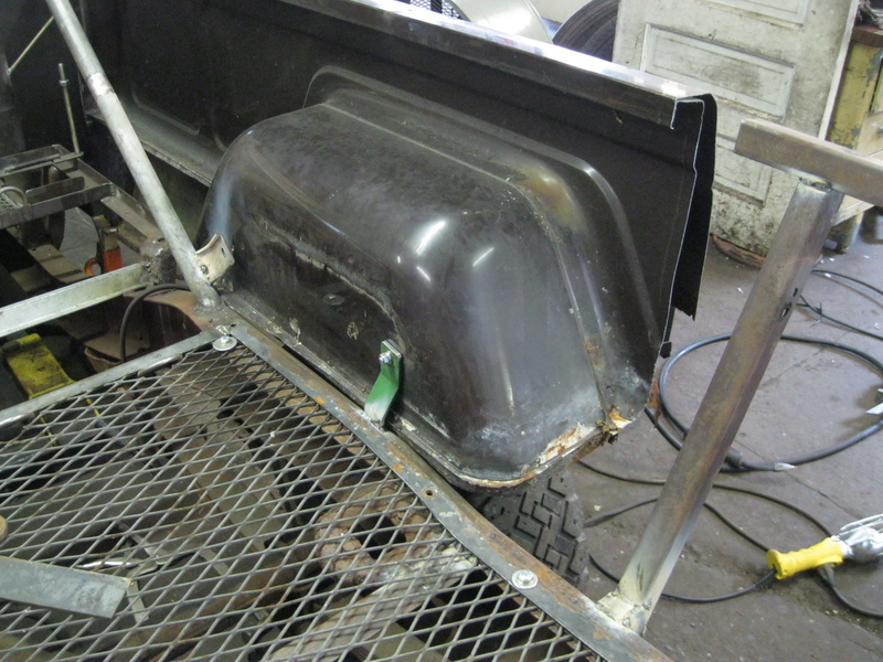

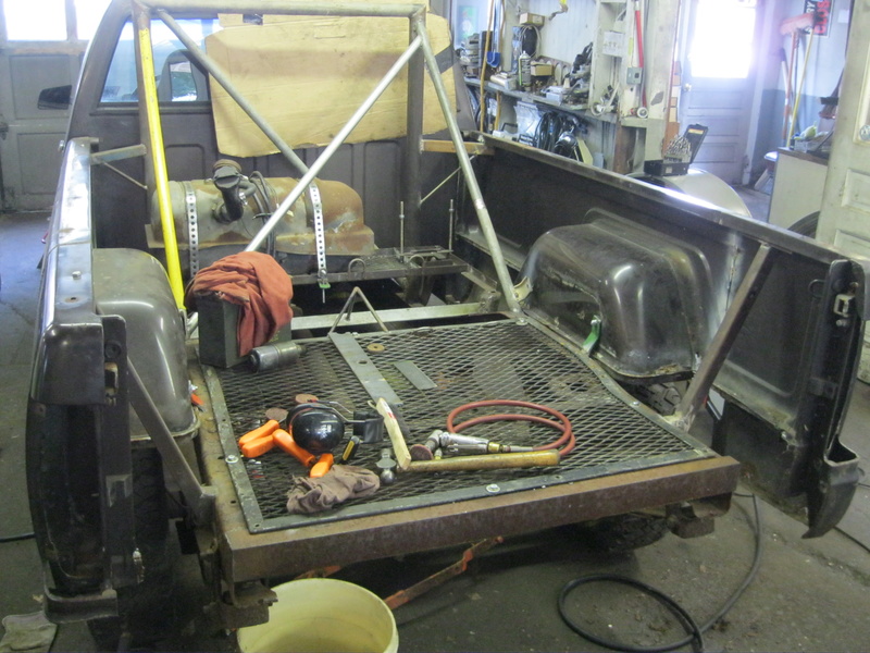

| A little bit of hack job body work in progress  Welding done and fender re-cut as original. The back part has been reshaped a bit.  Better view of the spare tire rack and how the tires will be held with straps. Both will be mounted on rims of course, but at the time, I only had one spare mounted.  The cross bar/brace on the down tubes of the roll bar fit nicely around the spares, which are also out of the way of the cargo space to the rear.  Here you can see where the straps hook up front. Most of what you can see here will be hidden once the bed side is on.  | |

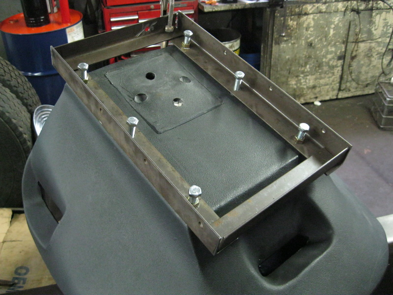

 | Subject: Re: ATLTF.COM Chevy Race Truck May 20th 2017, 8:17 pm | |
| Started working on a seat bracket. Decided to start with this square section of angle iron, still needs to be welded together.  I guess there will be some legs that go down to the floor. The bracket will either be bolted down or welded, once I figure out the best place to set the seat. No adjustment might be a pain for some people.  | |

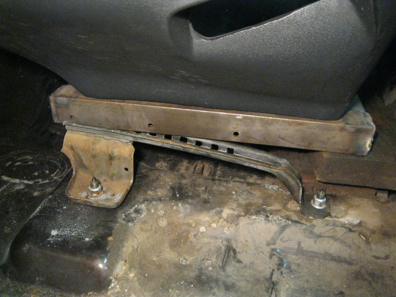

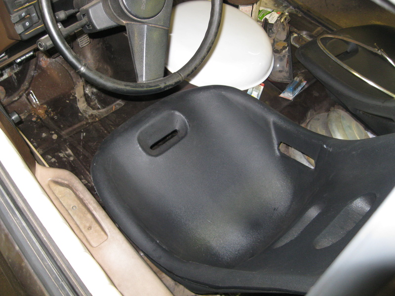

 | Subject: Re: ATLTF.COM Chevy Race Truck July 23rd 2017, 2:40 am | |
| Taking the stock seat brackets off the original seat. The plan is to use the original seat bolts for one half of each bucket seat. The other side I'll make my own.  Did some more test fitting. Turns out the seats don't need to be mounted all that high to be in the right spot.  This is about where they'll end up.   Still need to finish the other bed side and get it mounted. Also after hooking up the fuel lines to move the truck in the garage, one of them broke, so I need to run new lines. | |

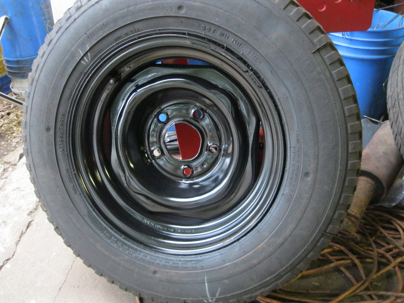

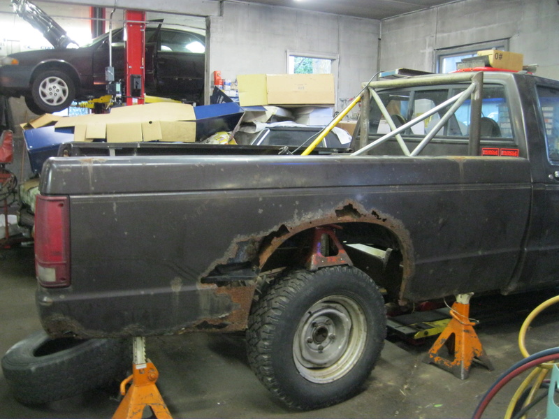

 | Subject: Re: ATLTF.COM Chevy Race Truck July 27th 2017, 1:48 am | |

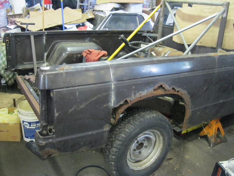

| Starting work on the second bed side. This time I'll make the brackets on the truck first and then shorten the bed and do the body work.  Rust around the wheel area same as the other side.  Painted the one nice spare rim and patched the tire which had a leaking plug. One more spare still to go, plus the ones actually on the truck.  Part of the old seat bracket about to be welded to the new seat bracket. On the opposite side of the seat, I'll have to make my own as there was only two brackets from the old bench seat. At least this will take care of half of it.  | |

| Mounting tabs done for the right bed side and 1st cut made   Shortened the removed section and welded it back on  Still some body work to finish on the right bed side. Sides are almost done.  | |
