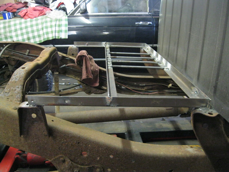

| Truck backed into the shop, fuel tank removed. Working on making a new mount for it behind the cab so it won't hang down so low.  | |

| Nice! Like the seats. You could mount the fuel tank to the roll cage. | |

| Thanks. Planning on having a skeleton like platform welded to the frame just behind the cab which the fuel tank and battery will both sit on. Then the roll bar will be welded to the frame just in front of that. I'm working off of those pads that stick up off the frame where the bed used to bolt on to. | |

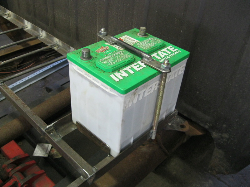

| Battery tray and hold down complete. Was going to leave the end piece out so various length batteries can fit, as some as the same width, but decided it would be simpler to just use this one size. This is a group 35. Threaded rod is 7/16, a bit heavier than needed, but it was what I had laying around.  Fuel tank will have two straps over the top to hold it in place. Here on the front of the frame for the tank, are two loops/brackets for the straps. Strap will loop around them and bolt back to itself. On the other side of the tank, the straps will have a threaded rod bolted to them, which will tighten them down.  | |

| I like it man! Should hold the battery and fuel tank pretty good  | |
