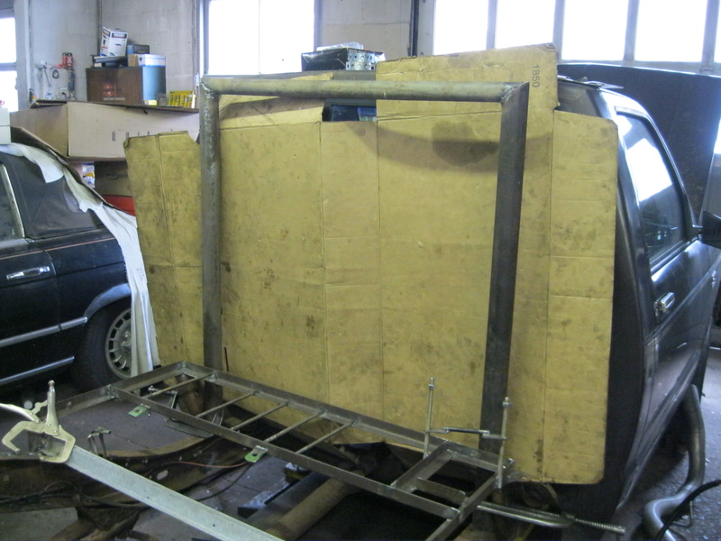

Roll bar now welded to the frame, bed side set in place for measuring. Doug Fackler seen working on his documentary film operation... Notice how far the bed side sticks out past the frame.
ATLTF.COM Chevy Race Truck - Page 4 Img_5915
Yellow markings near the back of the bed side indicate area to be removed
ATLTF.COM Chevy Race Truck - Page 4 Img_5912
Bed side shortened 11"
ATLTF.COM Chevy Race Truck - Page 4 Img_5914

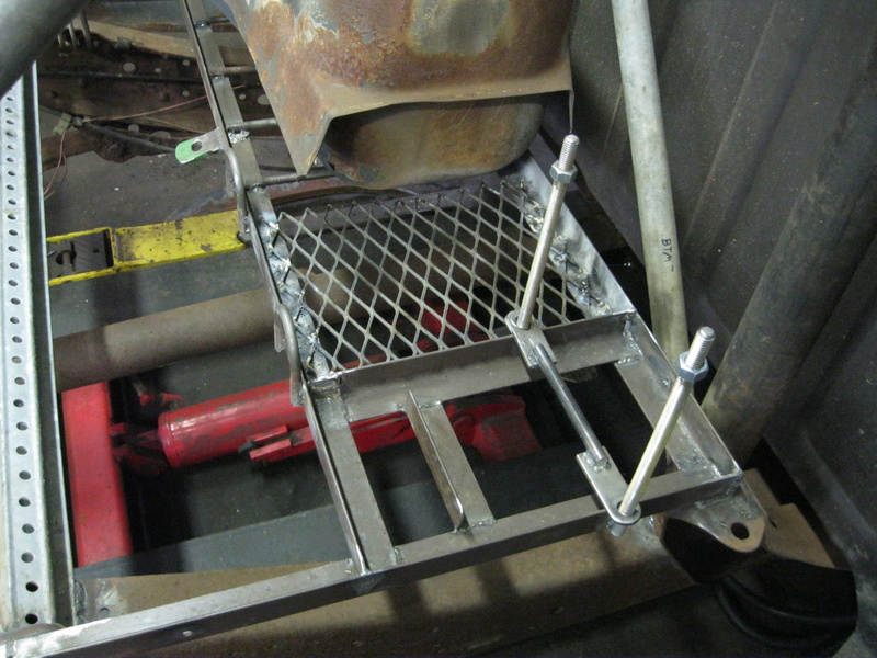

Lower forward brace for the bed side, actually bolted to the same place the original bed was bolted down.
ATLTF.COM Chevy Race Truck - Page 4 Img_6012

Fuel tank straps and adjusters in place. Adjusters are just some 5/16" threaded rod welded to a washer.
ATLTF.COM Chevy Race Truck - Page 4 Img_6013

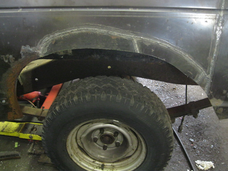

A little bit of hack job body work in progress
ATLTF.COM Chevy Race Truck - Page 4 Img_6018

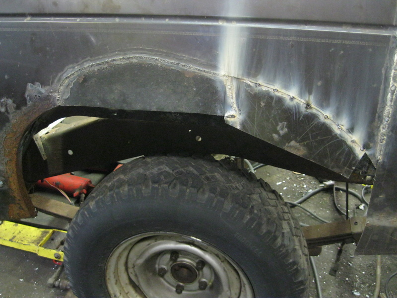

Welding done and fender re-cut as original. The back part has been reshaped a bit.
ATLTF.COM Chevy Race Truck - Page 4 Img_6020
