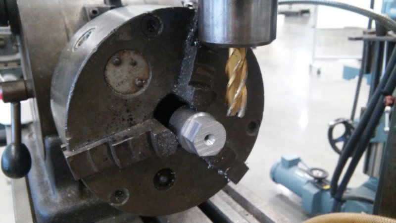

Machining the flats on the dividing head. This is the easier of the two types of bushings, the other kind has 6 flats.
MTD - "Budgie"  - Page 8 20180837
Points : 4905
Posts : 2492
MTD - "Budgie"  - Page 8 Empty
PostSubject: Re: MTD - "Budgie"    MTD - "Budgie"  - Page 8 Icon_minitimeAugust 22nd 2018, 7:55 pm
Handy attachment to have for just this reason.  Should make 6 flats a breeze.

yeah it does.  Looks like a blast using that indexing head with a three jaw chuck on the bridgeport.
Points : 6204
Posts : 3401
PostSubject: Re: MTD - "Budgie"    MTD - "Budgie"  - Page 8 Icon_minitimeSeptember 24th 2018, 8:31 pm
That's a Lagun mill. Just happened to be the one that was closest to where the dividing head was sitting when i went to put it on lol! let me tell you, that thing's heavy!

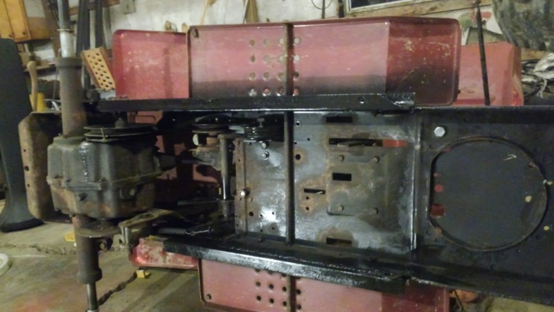

Working on reinforcing the frame. Not sure if you guys are gonna be impressed or are gonna say "yeah looks like a pretty RROD type job"

So that's like 2-1/2"x1-1/4"x1/4" channel steel, she's pretty stiff now. Still needs some support on the topside of the frame, I'm working on that now

I'm impressed with the reinforcement.  You're welding in some C channel right where they would go if this had a c channel frame in the first place.
Points : 8223
PostSubject: Re: MTD - "Budgie"    MTD - "Budgie"  - Page 8 Icon_minitimeOctober 1st 2018, 10:50 am
Ooh we've tuned into the C Channel, my favorite! lol!
Looks good Rich, should be an improvement for sure. Also those tabs right at the front of the C-channel look good for the front mounts of a skidplate.

Took a pretty simplistic approach to the belt guard; another piece of channel bolted to the frame and trans mount. Will probably be integrated into the skidplate later on.
MTD - "Budgie"  - Page 8 20181013
Frame is really stiff. No problem with it bending now. Took her out for a ride and crawled around a bit, did nicely. Need better tires and some more weight on the front end, though.
