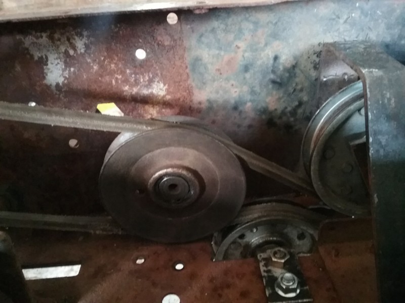

 | Subject: Re: MTD - "Budgie" July 16th 2018, 3:29 pm | |
| Test fitting stuff  Gonna put a flat idler on the clutch here to pinch the belt kinda, like a double pulley clutch i guess.  Cut out a bit for the belt, gonna need an idler too to keep it off the steering. Oh, and the inside of the frame there is gonna need some added support, its a bit flimsy from the bit i cut out.  | |

 | Subject: Re: MTD - "Budgie" July 16th 2018, 9:49 pm | |
| I'm liking this horizontal shaft conversion so far. Seem like the hardest part is building the clutch. Routing the belt seems pretty straightforward. | |

 | Subject: Re: MTD - "Budgie" July 29th 2018, 5:39 pm | |
| Support from deck strap thingy  Think I'm gonna put this idler somewhere here to help clutching action and keep the belt from touching itself  | |

 | Subject: Re: MTD - "Budgie" July 29th 2018, 7:30 pm | |
| Put the extra idler on. I'm not confident in this many idlers, but i guess we'll see how it goes  | |
Age : 23 Join date : 2016-04-12 Points : 5529 Posts : 2617 Location : Indiana
 | Subject: Re: MTD - "Budgie" July 29th 2018, 9:20 pm | |
| That’s gotta add some amount of drag | |

Age : 21 Join date : 2016-10-29 Points : 6028 Posts : 3315 Location : Lewisburg, KY
 | Subject: Re: MTD - "Budgie" July 29th 2018, 9:43 pm | |
| Definitely. Hopefully these 3 idlers and the one jackshaft pulley isnt too much for it. It's not too bad when i roll it over, but I'll only really know when i get it running lol. It certainly won't be too much for a gx390... | |
Age : 19 Join date : 2017-06-09 Points : 5063 Posts : 2640 Location : Literally Nowhere, Texas
 | Subject: Re: MTD - "Budgie" July 29th 2018, 9:55 pm | |
| Well, that's a lot of pulleys that can seize, and it only takes one to ruin the belt. | |

Age : 34 Join date : 2017-10-30 Points : 4756 Posts : 2434 Location : Rochester, New York
 | Subject: Re: MTD - "Budgie" July 30th 2018, 7:54 pm | |
| Reusing the vari drive for the clutch and adding in a couple of idlers seems like a solid way to get rid of that belt twist. I hope you find a belt that works. | |

 | Subject: Re: MTD - "Budgie" July 31st 2018, 2:19 am | |
| Clutch linkage yay   Normal operation yay  Hmmmm jam the clutch pedal all the way down to the tire and it kinda inverses the clutch action. Kinda cool that that happens but i dont wanna die so it'll get a clutch stop i guess  I stole mutts belt and it kinda works but the belt wont really stop, even if i start her in gear. Makes for fun situations. Guess I'll be getting her an inch or two bigger belt than mutt uses. | |
