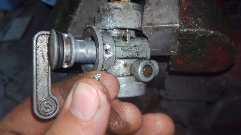

The petcock on the F11 decided to start leaking too, and when i went to go take it apart the screw holding the valve in broke the head off. Had to cut a slot in what was left and grind a screwdriver to get it out. Replaced the O ring and it's all good. I'm neener tired of pulling miracles on stuff.
