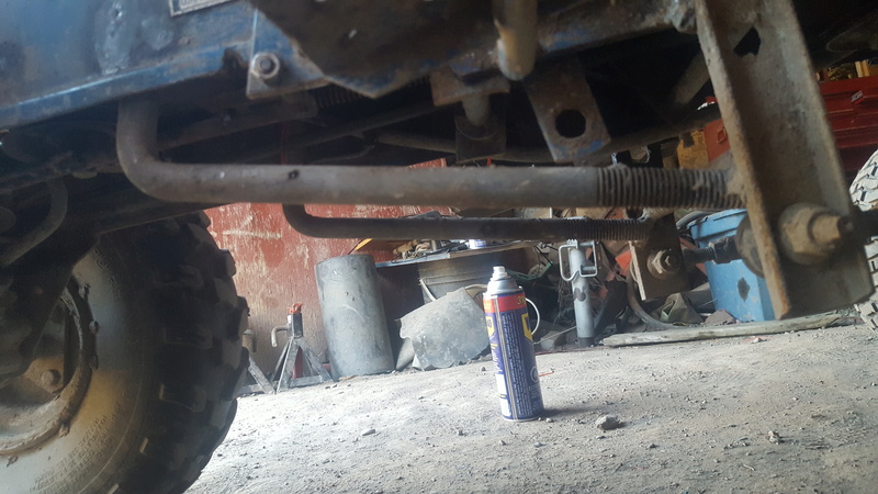

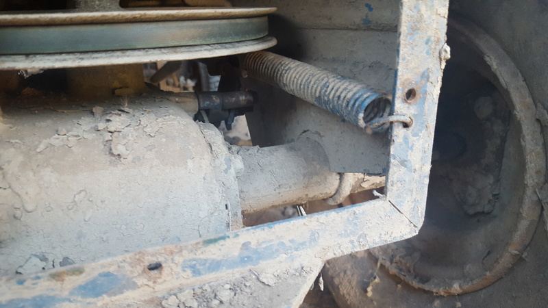

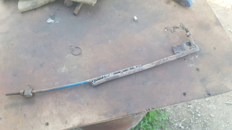

| Well I finally got some brakes rigged up on the little Ford today. A short while a go I made a setup that hooked to my deck handle, which seemed to work nicely. However, no matter how I adjusted the caliper arm the pads would not grab the rotor at all. I tore into it today thinking the pads were fried but actually discovered this: Yep, someone put the arm on backwards. Hahaha. So after I cleaned and lubed everything up I put it all back together and made up a new linkage. This is the handle with the brakes disengaged: The linkage tucked up nicely underneath: Then the return spring at the back: Also when I initially made the brake setup I welded in these heavy duty braces for the radius arm brackets: The brakes work great! They slow it down right away, and I also have a parking brake now because the handle locks in place. Which is pretty handy. Let me know what ya think! "This'll either wake you up or put you to sleep forever!"- Red Green "Whatever you do you should do right, even if it's something wrong." - Hank Hill - MTD Off-Road Build - Ford LT 110 Off-Road Build - Craftsman GT 6000 Off-Road Build - Sears LT11 Rat Rod Build *2019 Build-Off Winner!* Garden Tractor Collection: Allis B-110 x2, 710, 716, & 410 - Wheel Horse 655, 953 & 500 Special - Case 444 - Bolens Versamatic, G10 & 1668 Diesel Swapped - Cub 106, 124 & 1000/149 Frankentractor - Ford 120, LGT 125 & 145 - White 1650 Yard Boss - Moto Mower 710-100 | |

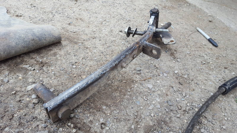

| *Major Front End Re-Vamp Time* Yep, about time the ol' Twin I-Beam got some love, now that I've gotten it to the point where it's no longer in the "experiment" phases, I figured it was time to blow it apart, brace it up, and give it some good paint. All apart! First I added some gussets on both the pivot knuckles: Planning on adding grease fittings as well. Then on to the beams. I welded rod all the way through and added a gusset for the radius arms mounts: Pretty heavy now, haha. Then I cleaned it all up for some paint: Went with a gloss black Tremclad paint for the beams and stuff. It's brushed on so won't be the prettiest thing, but I used it because it's quite durable and it's only the front axle stuff. Super high-tech mobile paint station Then same stuff for the other beam: Also got all my radius arm brackets on the frame side cleaned up and painted: Unfortunately that's all I got done today, haha. Everything should look real nice painted up though. Tomorrow I'm gonna tackle making the radius arms look a bit more professional, clean up and paint the coilovers, fab up a new drag link, and I'm also toying with making some actual shock hoops for the coilovers. I also have a pretty neat plan to modify my tie rod setup to make it work better with the Twin I-Beam setup, but I don't think I'll be able to get that done tomorrow, so that'll be for another time. Haha But yeah, hopefully the ol Twin I-Beam setup will be a lot better looking once I'm done everything. Let me know what ya think! "This'll either wake you up or put you to sleep forever!"- Red Green "Whatever you do you should do right, even if it's something wrong." - Hank Hill - MTD Off-Road Build - Ford LT 110 Off-Road Build - Craftsman GT 6000 Off-Road Build - Sears LT11 Rat Rod Build *2019 Build-Off Winner!* Garden Tractor Collection: Allis B-110 x2, 710, 716, & 410 - Wheel Horse 655, 953 & 500 Special - Case 444 - Bolens Versamatic, G10 & 1668 Diesel Swapped - Cub 106, 124 & 1000/149 Frankentractor - Ford 120, LGT 125 & 145 - White 1650 Yard Boss - Moto Mower 710-100
