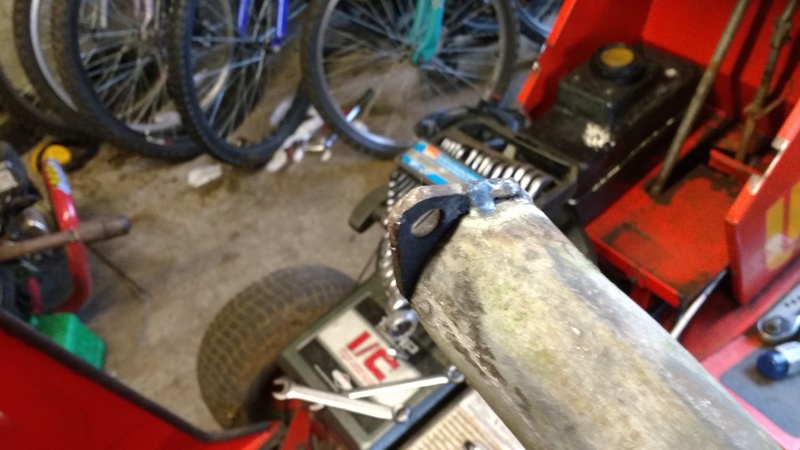

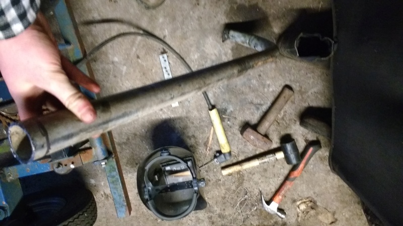

Got a slight bit more done on the exhaust.
Piece of a gate cut out to use as the exhaust.
'86 Westwood T1200 - Page 6 Img_2111
'86 Westwood T1200 - Page 6 Img_2112
Started to weld the flange onto the pipe.
'86 Westwood T1200 - Page 6 Img_2113

Looks good, are you going to have issues with the bolts and the pipe? Looks kind of close to the bolt holes. I have that problem with my sears.

Thought someone would ask that! I'm using allen head bolts and if necessary I will ding the pipe in to clear the bolts.

That's what I had to do for the header pipe on the rat rod. It uses Allen head bolts and I took a grinder to the pipe next to the bolts just enough so they would squeeze by.

Gotcha, I need to look into removing the posts from my honda clone to use hex heads instead of nuts. I need to update the exhaust this spring on the sears.

Exhaust is nearly done. Cut to length. May shorten it even more if need be.
