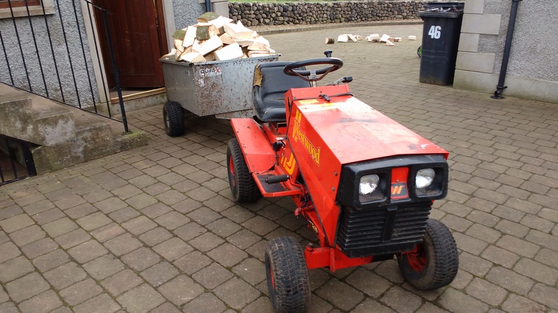

| Fairly sure it is a trans problem because it nothing else seems to be causing it. Been using the Westwood quite a bit today, drawing wood etc.   However, I noticed that the belt slips quite a lot in 4/5th gear esp. with a trailer on. I'm just gonna add another idler in to take up the slack. | |

| So added an idler pulley, seems to have solved the slipping issue. Clocked her at 21.37mph today! Now that I've got her running I've a list of improvements to make - Fix whining/screeching noise in trans

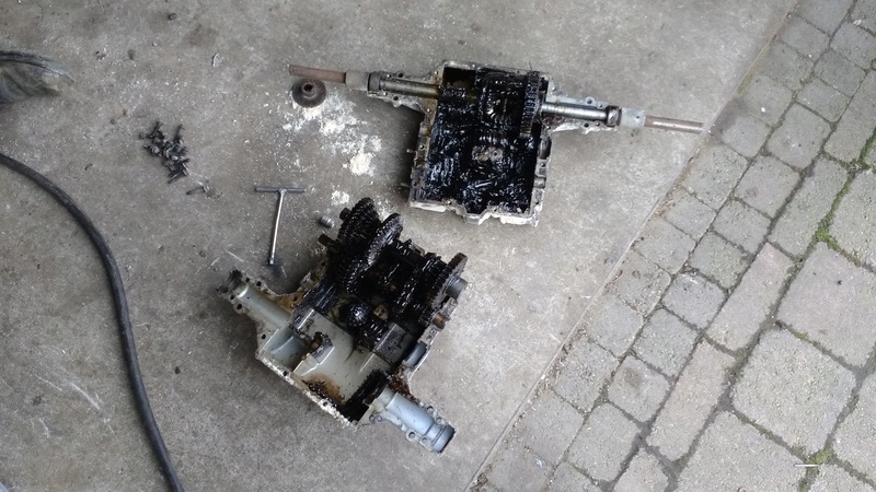

| I found a 6 1/2 inch pulley that I'm either going to use on the front or rear. Anywho, been looking at ways and means of locking the 832 trans I have. Opened it up, its design uses the robust diff carrier setup.   Now, after watching all the related vids, I believe the best and safest way to lock a diff is the Doc Locker Weldless 2.0. However, am I right in saying that it won't work (with out modification) on a trans with a diff carrier? Or has anyone modified it to work on a 800 series with a differential carrier? | |

| Oops! Forgot about that one  Thanks Rich!  Now all I gotta do is buy a 3/4 hub and a 3/4 axle. | |
