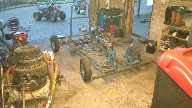

Thanks Mr.Mod!  So, finally the go kart is inside and ready to be transformed.  I had originally planned on putting a 12hp briggs flatty in and using the foote 3spd etc, but since I have this 6hp diesel laying around I think I'm gonna use it instead.  Gonna swap the thin rears for wider turfs, just gotta get some 4 stud rims from somewhere.  | |

| I'm wondering whether to run a torque converter or a centrifugal clutch. The current axle sprocket has 45 teeth. I'll see if I can get a 60 tooth sprocket. | |

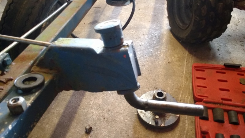

| About time I done something on this project. At the moment the goal is to get a rolling chassis. I'm replacing the rear tyres with a pair of 18x8.50 Carlisle Turf Hoppers on 8" rims. I do need to drill out bolt holes which I am hopefully going to do over the next few weeks. Thanks for the help TheBeal. I removed the front hub to use as a template for drilling the holes.   Quick drawing of the hub just so I can write down my measurements.  Look familiar? This is actually the end of a lawnmower front axle welded on to the suspension setup.  | |
