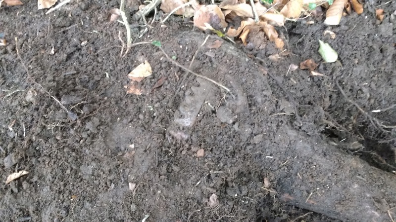

 | Subject: Re: Go Kart Project April 9th 2017, 5:13 pm | |
| Thought this is interesting. Found it buried in one of my fields yesterday.  It's an axle with two drum brakes and an open diff. Trying to dig it out.    I don't know what it's from or how long it's been there. There's a disused narrow gauge railway behind the fence where it is that closed in the 30s so at first I wondered if it was an axle from a wagon or something but it wouldn't have a differential. It's probably something someone has left there and over time it has been buried in the soil. | |
Age : 47 Join date : 2016-09-06 Points : 12913 Posts : 9151 Location : Oklahoma
 | Subject: Re: Go Kart Project April 9th 2017, 10:01 pm | |
| That is quite the interesting find! Appears to be in decent shape for who knows how long it has been buried.
