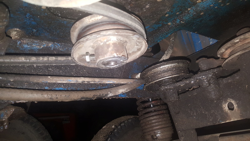

Well the drive pulley kept falling off of the Ford recently, and the crankshaft threads are stripped so I couldn't put a bolt in the ends. What I decided to do was simply drill and tap a hole for a little bolt to use as a set screw.
Ford LT 110 Off-Road Build - Page 5 20171019
Ford LT 110 Off-Road Build - Page 5 20171020
Works pretty good!

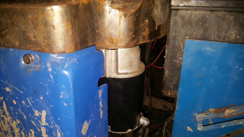

Yup, cleaned off the starter gear teeth pretty good... I'm gonna get a new gear and then use this trick to prevent it from happening again:
Ford LT 110 Off-Road Build - Page 5 Screen11
Hopefully that works out, we'll see I guess.

Sucks about the starter man. Hope that trick works for you. I've heard once an OPPY eats a gear that they just continue to eat them. I have been lucky so far in that dept.

Hmm, not sure why those pictures are upside down? But yeah, the aftermarket startes are the ones known to do it I think. That's why I would like to try that trick with the mounting hole, cuz it would suck to have it happen every few months hahaha.

So they are saying the gear does not engage fully because it is too close?  Hmm.... Good to know.

Too far away I think. If you look at how the hole is being carved out a bit that would allow the starter to move just a bit closer. I'm guessing if the gear isn't quite close enough it could possibly skip, and once that happens it's over haha.

Yeah... too far. I don't know what I was thinking last night. Ford LT 110 Off-Road Build - Page 5 2429134702
Still good info.

We have our starters have a .025 to .060 gap of clearance for proper mesh of the gear to flywheel. But that is on automotive engines. Should be a good gap though. You can use a big paper clip which is .040, and a small paper clip is .035, that's right in the middle of the clearances needed. You want either the starter tooth pointing to the center of crankshaft, or the flywheel tooth pointed to the center of the starter armature. measure both ways and use the smallest measurement between the 2. And that's with the starter gear engaged into the flywheel, when you measure gap at the tip of the tooth.

Thanks for the info prancstaman, I'll try that once I get a chance to work on the ol' girl again.

Well I decided to change the stripped starter gear so I can drive this thing again. I didnt end up modifying the mounting hole, but if it strips again I will definitely do it.
So here's the old one.
Ford LT 110 Off-Road Build - Page 5 20171123
Apparently I forgot to take pictures of the process, but whatever hahaha. Either way I put a used one that looked almost new on the starter and bolted 'er back up.
Ford LT 110 Off-Road Build - Page 5 20171124
Works great again!
Ford LT 110 Off-Road Build - Page 5 20171125
I sure am happy to have that fixed haha.
