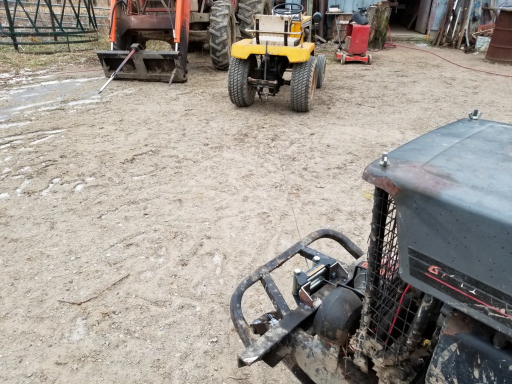

Anyways, today I got an upgrade for this rig I've been wanting to get for some time now:
Craftsman GT 6000 Build - Page 21 20190121
Finally picked up a fairlead! Haha. Should be a welcome upgrade for sure. Now I just gotta fab up a mount for it and get it bolted up, should be pretty straight forward.

Hey man I have this idea for a horizontal shaft GT6000 like yours. You should consider rotating the motor 90 degrees to the right and running the belt off of the crank and running it straight like a sears or wheel horse. Just an idea but I think it would be cool and simplify the whole belt system.
Points : 4579
Craftsman GT 6000 Build - Page 21 Empty
PostSubject: Re: Craftsman GT 6000 Build   Craftsman GT 6000 Build - Page 21 Icon_minitimeSun Jan 06, 2019 5:55 pm
You're not the first guy to suggest that lol.  One thing I know about @AllisKidD21 is that he hates messing with belts so I don't foresee him doing that.
Points : 7949
Posts : 5165
PostSubject: Re: Craftsman GT 6000 Build   Craftsman GT 6000 Build - Page 21 Icon_minitimeSun Jan 06, 2019 6:56 pm
That definitely would simplify the belt setup, and probably would be a pretty straight forward mod. Although I like having the engine sit with the crank parallel to the frame. Makes it pretty easy to work on that way and I also like the look, Haha.
I'll probably leave 'er the way she is. Thanks for the idea just the same though.

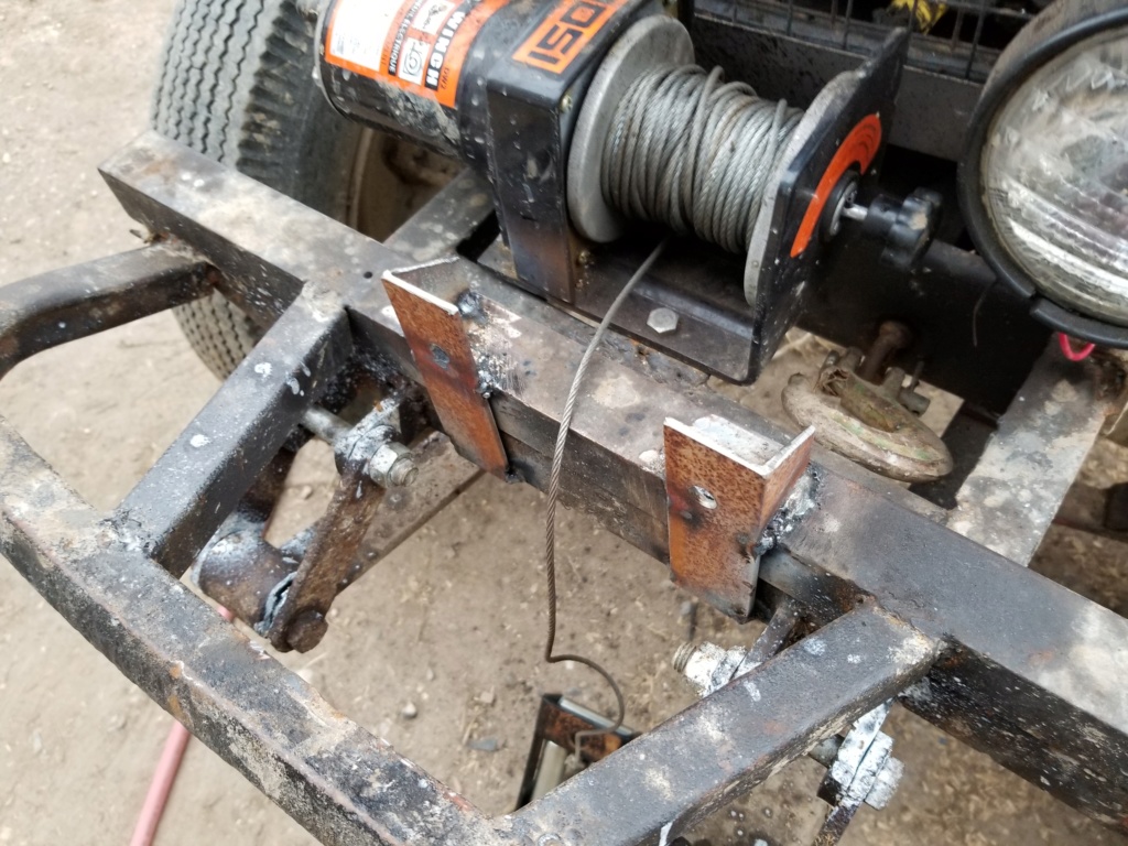

Minor update here, got the fairlead mounted today.
Just made up some simple angle steel brackets and drilled two holes for the mounting bolts.
Craftsman GT 6000 Build - Page 21 20190127
Welded up:
Craftsman GT 6000 Build - Page 21 20190128
Installed!
Craftsman GT 6000 Build - Page 21 20190129
Perfect! Seems like it's in a good spot for sure.

Love the bracket mount for the fairlead. Love how your rigs have purpose and will get used.

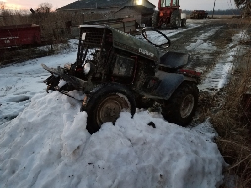

Well, this is what stuff being frozen to the ground, and one too many reverse gear clutch dumps will get ya:
Craftsman GT 6000 Build - Page 21 20190245
Craftsman GT 6000 Build - Page 21 20190246
Yep, LOL. Whoops. Broke the mount.
So I cleaned everything up and welded it all a bit better. Then I figured the front mount bar could use some support underneath:
Craftsman GT 6000 Build - Page 21 20190247
Just a couple pieces of flatstock:
Craftsman GT 6000 Build - Page 21 20190248
Not the best overhead job, but oh well. Hahaha. Either way it should be stronger now for sure.
Added a couple braces up top too for the bumper, while I was in the bracing mood, haha.
Craftsman GT 6000 Build - Page 21 20190249
Had to learn the hard way this time, but she's all fixed up now and ready for action! Maybe I should quit abusing it a little bit now. lol!
Let me know what ya think!
