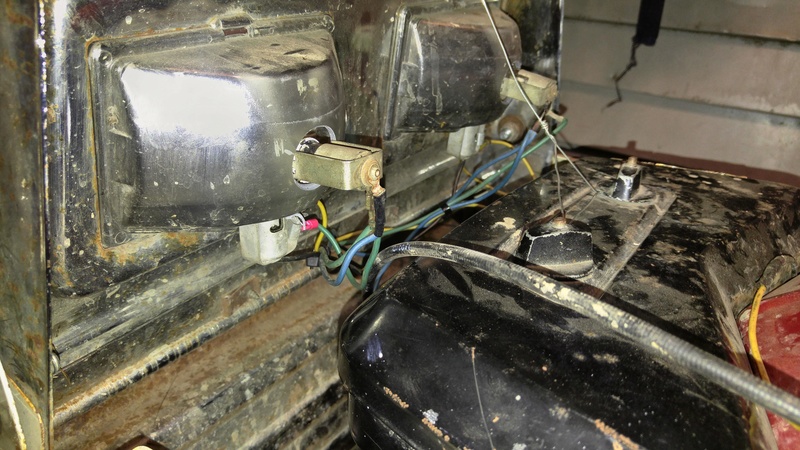

Today i made a gas tank holder.. so now it not only attached to the dash with zipties...
The 18hp Yard-Man Trailmower  - Page 7 20170826
The 18hp Yard-Man Trailmower  - Page 7 20170825
The 18hp Yard-Man Trailmower  - Page 7 20170827
The 18hp Yard-Man Trailmower  - Page 7 20170828
The 18hp Yard-Man Trailmower  - Page 7 20170829

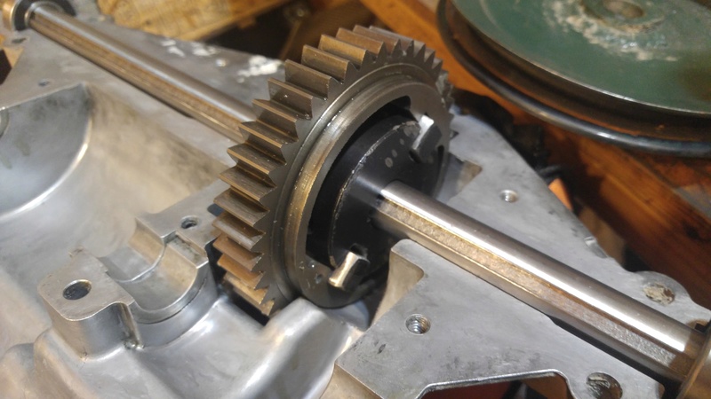

i cracked open the mst and inspected everything in there, looks great, cleaned out the case and startet the doc locker 2.0 !
The 18hp Yard-Man Trailmower  - Page 7 20170888
this is where im at.
The 18hp Yard-Man Trailmower  - Page 7 20170886
The 18hp Yard-Man Trailmower  - Page 7 20170887

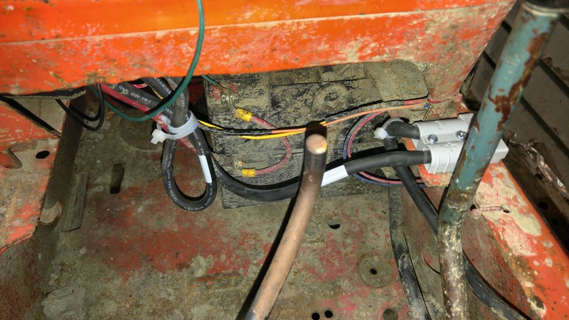

last weekend i properly rewired the thing with crimp connectors and all, got the boost system thingy nicely installed, rebuilt the starter with used brushed, again, and did a headlight mod.
heres some pics.
a couple months ago i bought a pack of cheap 1156 led tailight bulbs, 10 for 2$. but they are only rated to about 1.5W each, so about equivalent to a 15W incandescent. factory bulbs are 22W. so a single bulb per headlight wasnt enought, i just drilled a one inch hole in the enclosure and fitted some spare sockets i got off another tractor. worked great. now i have the equivalent of 60W of lighting but it only uses 6 watts, with the dual battery setup it means i could run them for days !
The 18hp Yard-Man Trailmower  - Page 7 20171010
Now i have leds all around !
wiring all cleaned up and ziptied haha
i also had to instal a choke cable, i could get it to start without a little choke, its getting cold here.. i still have to get a longer cable and install it in the dash..
The 18hp Yard-Man Trailmower  - Page 7 20171011
used a 50A anderson connector.
The 18hp Yard-Man Trailmower  - Page 7 20171014
ill make a couple of special cables, all my tractors have this connector hooked up to their batteries so i have a conveniant way to boost them or other tractors.. i can also use this connector to charge the batteries or extend the capacity of them by storing another one in the bumper and connecting it with the main ones. (now i always carry a small battery with the adaptor to boost the tractor if i drain the batteries on the trail)
The 18hp Yard-Man Trailmower  - Page 7 20171012
The 18hp Yard-Man Trailmower  - Page 7 20171013
i also ran a wire for the low oil pressure switch, ill get a red indicator led to install on the dash to show low oil pressure.. gettin fancy
