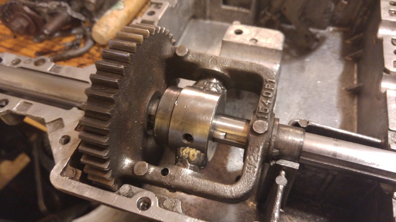

| i locked the differential with my new axle today. i just welded parts of the pin to the hub. i could have just welded the pin to the axle but then there would have been more leverage on the welds and i only have a small 80A welder, this way the welds are in alot less stress because the pins are really short.     i also cleaned up the bottom half of the case and the shift fork thing... tommorow ill try to get the top half cleaned and put the gears back in with some new gear oil. | |

| today i cleaned the top half of the case, the gears and reassembled the trans with new sealant.   now its all bolted back together and im waiting for the rtv to cure. i got some thicker oil in the hope that it will not leak out of the trans. tommorow ill put the trans back in and put the new belt on. mmm peerless...   | |

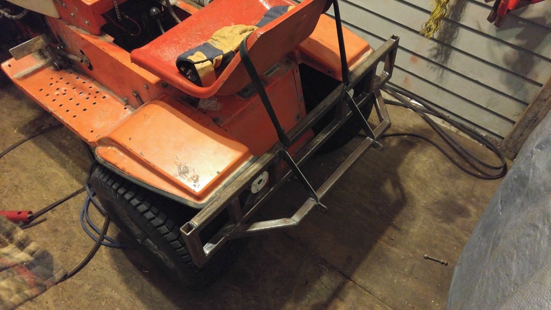

| today i got a a belt and went for a little spin.its a little faster but everything worked, except maybe that my front tires are super crappy so i took the front tires to an tire shop to get the 15 inch knobbies on the rims. i also mostly finished the rear bumper, i really like it the way it is right now, the only things left to do on it are the hitch and the mounts to bolt to the tractor. the bumper i just hanging there, i wanted to see how it looked.      tommorow ill install the knobbies and test them out, now i need to find myselft some rear tires. | |
TheBeal Veteran Member
 | Subject: Re: The 18hp Yard-Man Trailmower February 10th 2017, 9:16 am | |
| Thats quite the beefy bumper. | |
CraftsmanQuad19 Core Member
 | Subject: Re: The 18hp Yard-Man Trailmower February 10th 2017, 9:40 am | |
| Yeah I really like that bumper | |
 | Subject: Re: The 18hp Yard-Man Trailmower February 11th 2017, 4:25 pm | |
| Bumper looks real good. You shoulda kept the real axle long, rice rocket mower hahaha! Nice idea with the lock collars by the ways! _______________________________________________ "This'll either wake you up or put you to sleep forever!"- Red Green     "Whatever you do you should do right, even if it's something wrong." - Hank Hill      - MTD Off-Road Build    - Ford LT 110 Off-Road Build     - Craftsman GT 6000 Off-Road Build      - Sears LT11 Rat Rod Build *2019 Build-Off Winner!* - Allis B-110 x2, 710 & 716 - Wheel Horse 655, 953 & 500 Special - Case 444 - Bolens Versamatic & 1668 - Cub 106 & 124 - Ford LGT 125 & 145 - White 1650 Yard Boss | |
