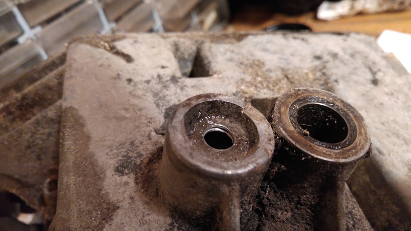

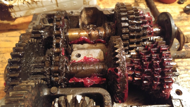

heres some pics !
The 18hp Yard-Man Trailmower  - Page 3 20161216
The 18hp Yard-Man Trailmower  - Page 3 20161215
The 18hp Yard-Man Trailmower  - Page 3 20161211
The 18hp Yard-Man Trailmower  - Page 3 20161212
The 18hp Yard-Man Trailmower  - Page 3 20161210
The 18hp Yard-Man Trailmower  - Page 3 20161213
The 18hp Yard-Man Trailmower  - Page 3 20161214
so its a nasty rusty mess inside but itll work.
i want to lock it but first i have to get the stuck tire and rim of of the axle.
ill probably fozzy lock it
http://gdftech.com
Posts : 2951
Forum Rep : 70
The 18hp Yard-Man Trailmower  - Page 3 Empty
PostSubject: Re: The 18hp Yard-Man Trailmower    The 18hp Yard-Man Trailmower  - Page 3 Icon_minitimeWed Dec 14, 2016 9:28 pm
Ohh yuck.

@Doug wrote:
Ohh yuck.
ya good thing i opened it its nasty in there.
ill have to clean up the grease get the stuck rim of lock it and convert it to oil lube.
http://gdftech.com

Oh boy is that thing nasty. Just soak it in some gasoline after you scoop what you can out.

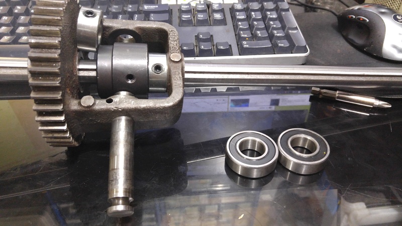

yep it was pretty nasty in there.
the cool thing is i have a complete spare trans so i have alot of spare parts.
today i got all the nasty betonite grease out and cleaned up everything.
i also drilled and tapped a drain and a fill plug for the oil.
i cleaned the diff real well because im trying to figure out how im going to lock it. im not sure about fozzy yet.
The 18hp Yard-Man Trailmower  - Page 3 20161235
The 18hp Yard-Man Trailmower  - Page 3 20161229
The 18hp Yard-Man Trailmower  - Page 3 20161227
The 18hp Yard-Man Trailmower  - Page 3 20161233
The 18hp Yard-Man Trailmower  - Page 3 20161230
The 18hp Yard-Man Trailmower  - Page 3 20161228
The 18hp Yard-Man Trailmower  - Page 3 20161232
The 18hp Yard-Man Trailmower  - Page 3 20161231
The 18hp Yard-Man Trailmower  - Page 3 20161234
i cleaned up the bearings and regreased them.
ill lock it tommorow i just have to figure out how.

Its locked!! I just welded the pin to the 2 spiders. Ill see how long it holds up. If it blows i have another trans that i can put a straight axle in.

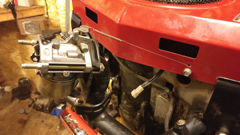

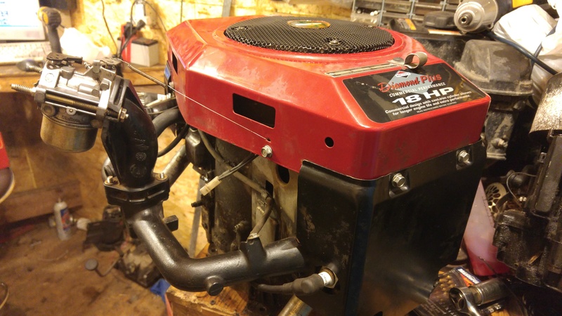

so this tractor is getting an 18hp opposed twin !! finally found one for cheap enought (30$), it wil be ungoverned, ill have to relocate the fuel tank and maybe find a bigger one. With that engine i might endup breaking the 801 again but i have spares lol.
i was thinking of putting an 8inch on the new engine, the trans has a 6 inch. i want some more speed and now with the new engine ill have more than enought power.
also i have brand new knobbies , i got them with a small 70cc chinese quad, im gonna put them on the front, they will probably be way better than the crappy smooth tires i have right now. they look to be 16 inch im not sure tho.
does anyone know how many amps the stock charging system produces on a twin ?
http://gdftech.com
Mudgutz_Customs
Mudgutz_Customs
Join date : 2016-10-12
Posts : 29
Location : perth, WA
PostSubject: Re: The 18hp Yard-Man Trailmower    The 18hp Yard-Man Trailmower  - Page 3 Icon_minitimeThu Feb 02, 2017 8:05 am
Don't quote me on this, I'm not 100% sure but its at least 3 amp and at the most 6 amp(?) But like I said, I'm not 100 percent.

finally got some time to work on the yard man. i got all the parts for the doc locker togheter, i got a bullgear from my spare trans and assembled most of the parts.
here it is.
The 18hp Yard-Man Trailmower  - Page 3 20170212
The 18hp Yard-Man Trailmower  - Page 3 20170211
The 18hp Yard-Man Trailmower  - Page 3 20170210
i also mounted a carb to the new opposed twin. it from a 16hp briggs intek. this carb is just to see if it runs, if the carb performs good ill keep it but if not ill have to find another one.
The 18hp Yard-Man Trailmower  - Page 3 20170215
The 18hp Yard-Man Trailmower  - Page 3 20170213
The 18hp Yard-Man Trailmower  - Page 3 20170214l]
oh i also realized that the new twin has pressure lube. i just dont have the dipstick tube ill have to find something to take its place.

Hm, I wonder where you got the idea for using that carb from?
I doubt a dipstick tube is that expensive, its only a piece of plastic and metal. How is the doc locker gonna work like that? Gonna weld in the pins to the carrier with a slot cut out for em in the hub?
mmm who could it be lol. thanks again, rro. turns out the stock intake from the intek flipped should work good enough for a test run
i know it shoudnt be expensive but i cant find where to get one. and ill just weld the pin to the hub and cut the excess, this way i cant still remove my axle if i need to.
@CraftsmanQuad19 wrote:
You found a pressure lube oppy???? That engine is one step short of being a unicorn
i know it doesnt fly... yet ! lol. but it did take 2 hours of nasty winter roads but i got it home. and for 30$ lol
